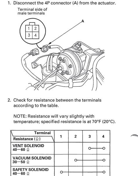

First thing you will want to do is test the resistance on the actuator......see if this pic comes thru.
