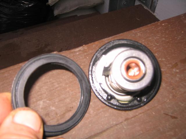

On my 92 Accord I obtained a replacement thermostat and gasket. I noticed that thermostat has a temperature stamped on it 170 degrees, whereas the one I'm replacing has 180 degrees. It is my understanding that OE for the engine would be 170 degrees. I would assume of course the original thermostat has been replaced already but with the 180 degree one. Is it probably better just use my new replacement one (170 degrees) or is it better for some reason to obtain another 180 degree replacement instead?
Also, I noticed a rather obvious difference with the aftermarket (from Car Quest) gasket, as compared with the one already installed which I was planning on replacing too. The aftermarket one here (shown in the photo, I'm holding it) doesn't have those bump/tabs on the rubber and is somewhat different otherwise as can be seen. Probably won't seal as properly as the old one there, so am thinking either try to get either closer or OE replacement or just re-use the old one because it actually looks fine. I noticed when I took the thermostat housing off there was a little red-colored sealant type material used also around the seal and I was wondering about that too.

It is well agreed that OEM thermostat is way to go. Faster warmup and more precise temp control. OEM is fully open at 90C (194F) which is what's stamped on thermostat body (from memory).
Not sure what bumps on OEM are for, but the slight cut-out is for a vent fitting that allows a little water/air to bypass a closed thermostat. It should be positioned at TDC in the housing.

The cut-out in the gasket is for the little vent (rattle-pin). The bumps alongside it will fit into corresponding recess in the housing, to make it "obvious" the correct orientation to install the T-stat. Without those bumps, you simply have to pay attention to the small recess where the vent belongs. The bumps don't actually contribute to how the gasket seals, they simply help you see the correct orientation.

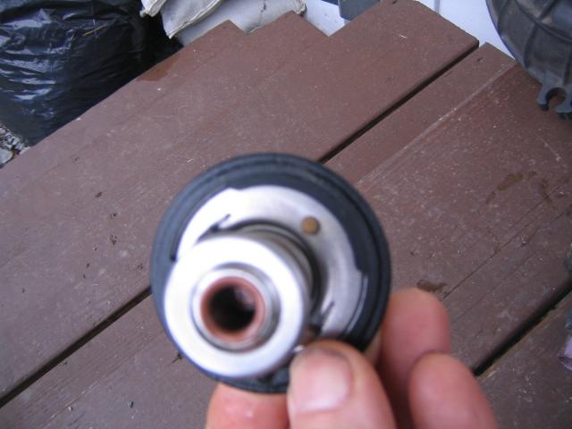

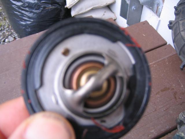

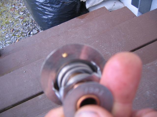

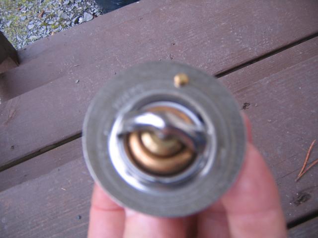

BTW, I don't see the little rattle-pin vent in your photo of the T-stat. Is the gasket clocked around to the wrong position? Or is the vent not present on your T-stat?
I'm not too clear on the question; I have no experience with these thermostats. So here's a couple pictures of the old stat (which I just took out and am planning on replacing):
And here's a couple pictures of the new one I got, which I was planning on maybe using as a replacement (when/if depending on whether I can decide if it'll be okay to use it):
Does it look by the photos provided whether the gasket is clocked around to the wrong position? I didn't move the position from where I found it when I took it out...
