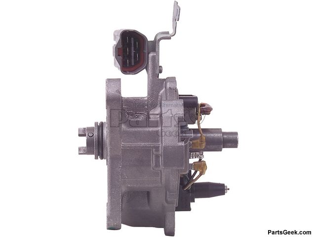

For reference, my distributor looks like this:
http://www.partsgeek.com/assets/dimage/full/1006137.jpg
It has the internal ignition coil and non-rotating distributor mount. When I remove the cap I can see the shaft bearing from the outside.

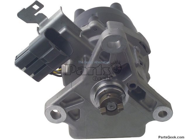

Here's a picture of what it looks like
http://www.partsgeek.com/assets/dimage/full/1035061.jpg
Does anyone know if these distributors are intended to be serviceable?
Thanks. John

The picture you show is of a different distributor. I think there were at least three different types of distributors used on these Accords.
It's hard to tell by the pics, but the housing on my distributor has a 2-3" long hollow tunnel cast into the housing with one sealed bearing on each exposed end of this tunnel ... no rubber seal viewable on either end ... and no top section to pull out of the housing to expose anything inside that tunnel.
If I could get the shaft out I could try to pull one or both of the bearings to see if a rubber seal is between the two, but seeing as how they are seated bearings, there should be a lip behind them to hold them in place in the housing ... which means no way to get an internal seal in or out of there.
The first thing I want to try is to remove the shaft ... possibly this distributor is servicable by replacing the bearings. But it doesn't look like the lock pin is easily removable.

Fyi, here's the best picture I've found so far of my distributor, showing the enclosed cast metal housing for the shaft and the lack of C-clip for the notch:
http://img.eautopartscatalog.com/liv...1110527OES.JPG
Fyi, I looked around the internet for anyone who has worked on this type of distributor ... still can't find anything. Not only do I need to get that pin out, but I also need to find replacement bearings that don't leak, or determine that the rubber seal is actually located behind one of the bearings.
