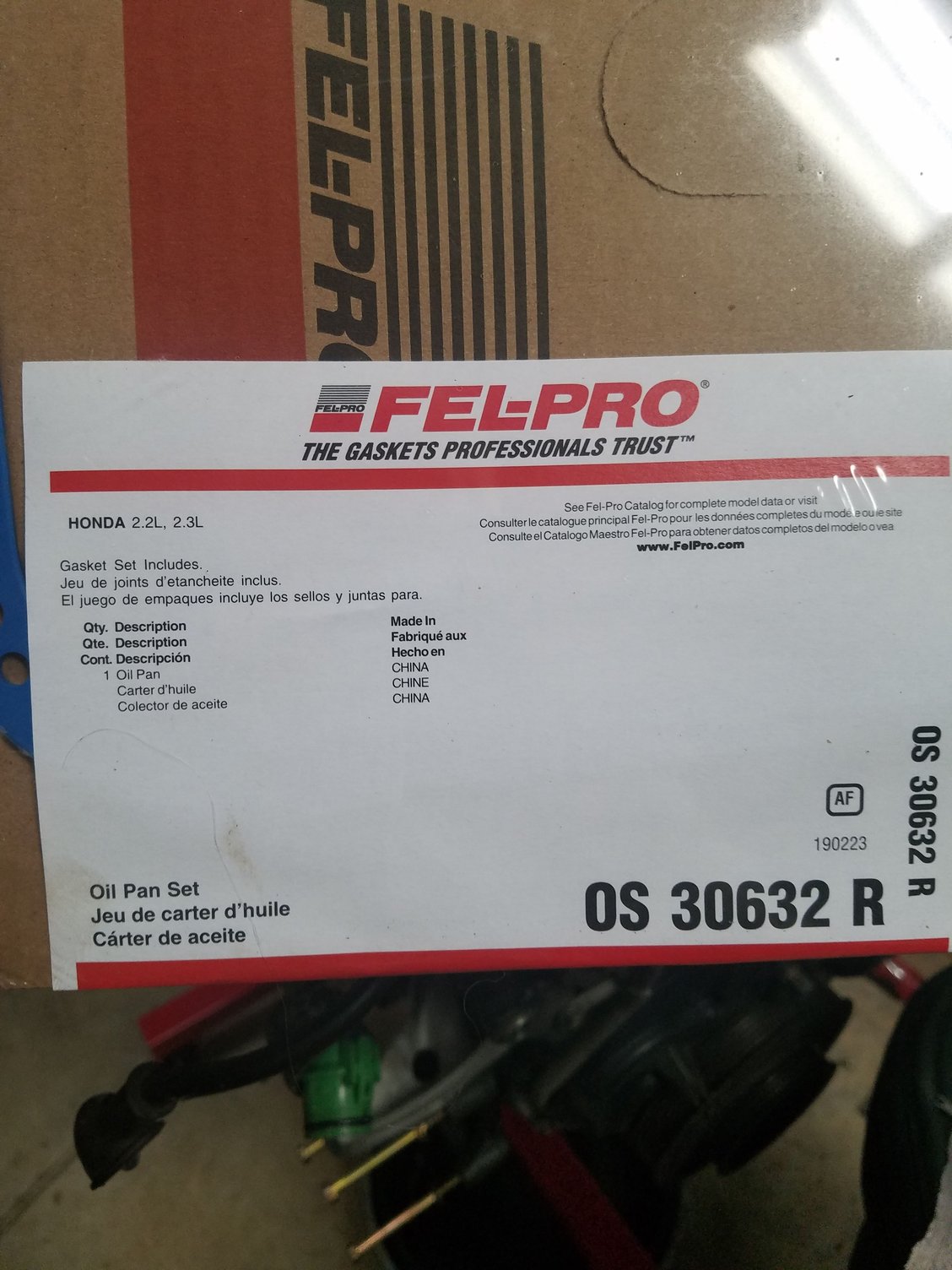

Default Felpro oil pan gasket
I am not sure if rtv is required on the oil pan gasket or not. I bought a felpro and cleaned the oil pan today. Was not able to finish the intake manifold due to another gasket from the water thermostat connection to the intake needing an oem gasket the local auto stores do not carry. The gasket is blue. Talked to Oreilly's later today and they said the blue ones are made to go on without any rtv due to the thickness and torqued down to factory specs. We'll see. Replacing it will be a huge PIA not on the engine stand if it leaks. I flipped the engine stand around to complete this one and it took like 10 minutes.

If I remember right, only the corners would need rtv. By that I mean where the tangs of the gasket go.However, if you look in the FSM, it tells you to use Honda bond for a gasket (grey rtv).
Old Jul 15, 2019 | 05:35 PM
I've also heard that Permatex "Ultra-Grey" is the same as Honda-Bond.

good info. Thank you guys for the help on the gasket issue. I am going to put a dab in the corners before the bend of the gray permatex 'hondabond' equivalent.

I talked to a local guy who works at oreillys and who builds honda's in his spare time. He said the felpro technically should seal, but there is no reason not to put some black/grey rtv made for oil pans from permatex in between the inner portion of the gasket the whole way around. He said he has done this both ways and thinks the permatex will help long-term if the gasket starts to shrink in a few years due to expansion/contraction. He said he has also had people who had gaskets leak - the felpro blue colored gaskets even when torqued to factory specs, so it really depends on the make/model of the vehicle as to how well the felpro works according to him.

You can do it however you want. Put it in the corners of the crank end where the tabs go, or coat the entire gasket, or just go without the gasket and use the rtv. It's your call. Honda used Honda bond. Those blue gaskets aren't meant for being used with silicone, except where it's called out (usually the tabs near the crank).
