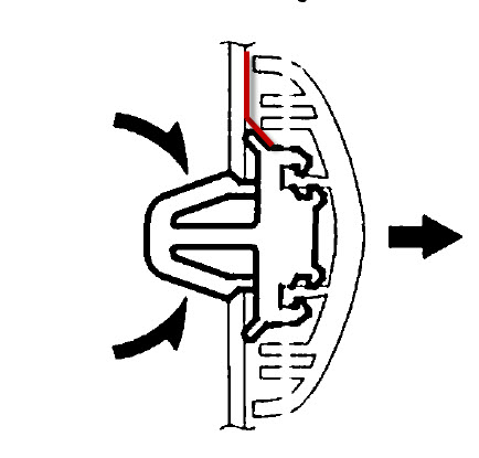

Posts: 7,101
It looks like the design of the clip is angled to prevent water (well most of it) from getting into the hole where the clip attaches.
Old Jan 11, 2013 | 06:58 AM
There's already water getting into the door, through the rubber seal at the bottom of the window. That's normal and there's drains along the bottom of the door.
I bet the trick is to clip on those parts without chipping any paint around the mounting holes.
