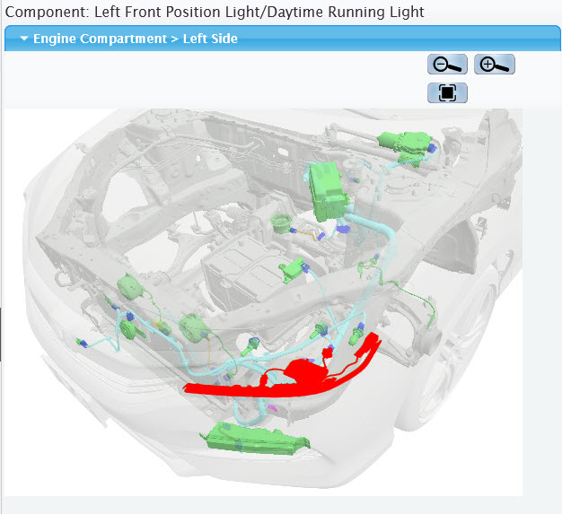

The LED DRL is part of the headlight assembly.
If you have a voltmeter, you can test that there is power to the left DRL connector. There is a 3P connector with 2 red wires and 1 black wire. Both red wire terminals should have power when the DRL are on. The black wire is for ground. -- But, most likely it is a faulty LED DRL.
If it is faulty, the headlight would be replaced.
The front bumper is removed first, then the headlight can be removed.
