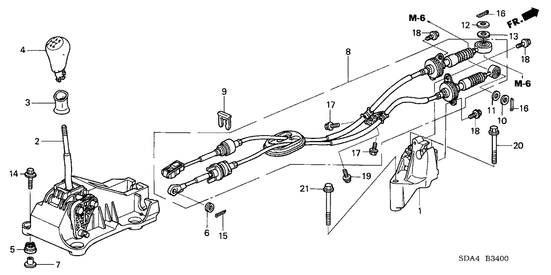

Here is a diagram of the linkage. Is the part number at the bottom of the image correct? Because I am pretty sure the number he gave me was different. I don't remember that number, but I don't think the B3400 part of the number is correct.

54310-SDA-L02 is the part number. I think if you can remove the air intake, you can replace that cable.
