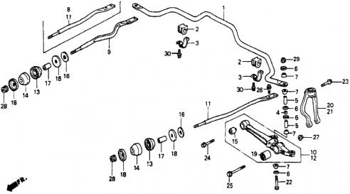

Crossmember and lower control arm are new?
I was thinking that the lower control arm is bent or something, but not if it's new. Is it possible to just pull the lower control arm towards the front of the car, flexing the rubber bushings, and connect the radius rod?
Attached Thumbnails f22a6, passenger front wheel off center-1992-front-lower-arm.jpg

BlindGungfu's Avatar
Joined: Mar 2013
Posts: 70
From: Kenmore, Washington
Yeah its all been replaced.
If I were to pull controll arm towards front then the radius rod just wouldnt go forward. The big bushings in crossmember keep it back. I need to drink some coffee then ill go and take some pics.
