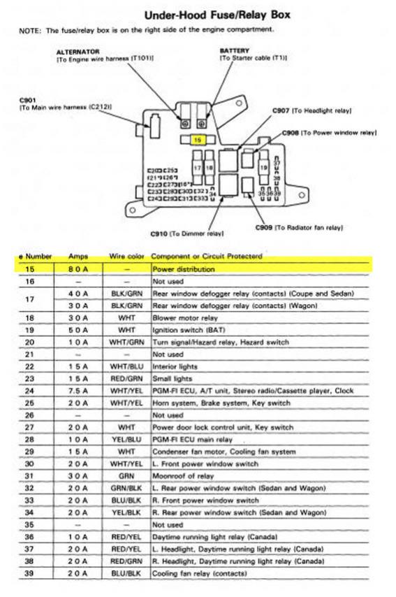

Like other said, check the main fuse first, it probably is blown. Here is a diagram showing the location in the under hood fuse/relay box. It should be held on with two Phillips screws. Replace it with one with the same amperage (e.g., if it is 80A, replace only with 80A).
Since it sounds like your car had no power for a while, once you replaced the main fuse and use a battery with a good charge, the ECU would already be reset.
