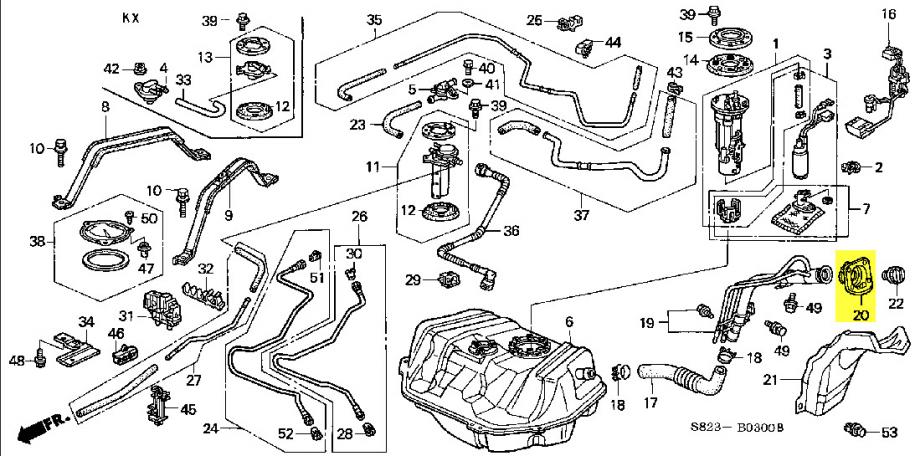

I have a 99 Accord EX, 2 door, V6, The little flapper in the fuel filler neck is gone causing an evaporative code. Do I need to drop the tank to replace the filler neck or can I bolt it in without all that work?
Old Jun 22, 2012 | 03:28 PM
On pretty much all the Hondas, you don't need to drop the tank. You may have to take a wheel well cover off and/or other type of cover off to expose the fill pipe then start unbolting and unclamping the fill pipe from the filler pipe gasket.
In this other thread, a guy replaced it on his Honda Pilot, similar part; but, different part number.
Honda Pilot - Honda Pilot Forums - View Single Post - Fuel Smell and CEL
For your car, it looks like it is Honda part number: 17662-S04-003

Your car has a fuel tank pressure sensor near the EVAP canister under the car (before the fuel tank), the ECU use that to help determine if there was a EVAP system leak such as a loose or faulty gas cap. From my understanding EVAP system leaks should not affect the car's performance. A leak at the fuel filler pipe gasket area would be an EVAP leak. The EVAP system is to prevent gas vapors from escaping into the atmosphere from the fuel tank system. Your first post stated there was an evap code.
The reduction in fuel economy and idle may be due to something else.
In the parts diagram I attached previously, part #21 is the fuel filler pipe cover. I believe you have to remove that cover to expose the fuel pipe and you should be able to replace the fuel filler gasket without the need to drop the fuel tank.
