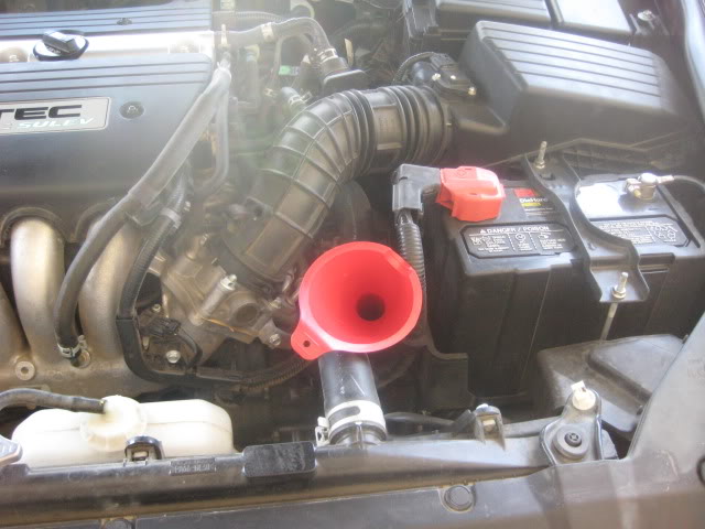

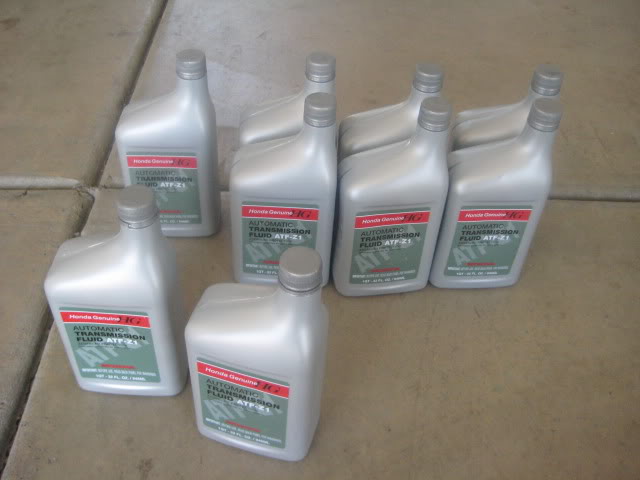

FINALLY got around to changing the transmission oil. VERY, VERY simple to do and saved me a bit o' cash.

I only did 9 qts, so that was 2 drain and fills (6 qts) and 1 fill in order to top off the tranny (3 qts).
