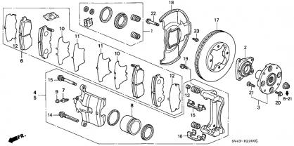

Problem is now the tire has a scrape sound which happens at a certain part of the revolution, right near the brake. Happens with the tire on of off, i can just spin the part the tire would bolt on to by hand and i can hear it. The sound seems to be the same pitch as hitting the black piece on the inside of the brake assembly (sorry i have no idea what its called), but I have tried bending it slightly and I cant get the sound to fully go away. Also as a side note the brake pads look like they are pretty much touching the silver part, but maybe that is how its supposed to look...is their a way to very slightly ajust the brake pads away from the silver part as a test, or do you think its something else?

Ok, sorry to even bother you but maybe it will help someone. I did manage to fix it in record time (lol) by taking a flathead and prying the black part (on the bottom half) away from the silver part. Thanks anyway O_o

So there's a sheet-metal splash guard (#18)... is that the part that you bent out of the way?
Sorta common for that to happen for one reason or another. That thing is there to help shield the brake rotor from water splashing when you drive through a puddle.
Attached Thumbnails Grinding / Scrape sound from brake area-96-front-brake.jpg

yup, thats the one. The brake disk looks pretty rusted around the circumference, but I believe that is normal. (contact point is still shiny) The shaft that goes up to the cv joint is also rusty, but I have read that its normally just surface rust. thanks for the reply.
