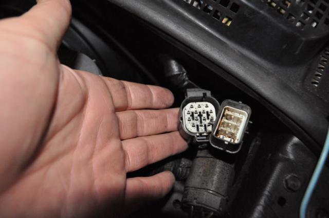

Wondering If Someone With Some Swap Knowledge Could Steer Me In The Right Direction, I Have A 95 Accord(Automatic Car) That I Am Dropping An H22A Into And I Have 4 Harness's On The Passenger Side Of The Car And One Flat Plug, Only 2 Of The Harness's match up and Im still left with 2 on the H22 engine harness but then on the driver side of the accord there are 2 plugs near where I installed the slave cylinder and no harness plugs on the engine on that side to plug into them, Im assuming the extra 2 plugs on the passenger side of the car are to do with the automatic trannie? Also the bolt hole in the auto engine mount bracket is a touch off from the 5 speed cars bracket, I have 6 accords and 3 preludes so I a few are donars so I can check out the different set ups, I didnt realize the brackets were different until I got the engine in and it didnt want to line up right, so is drilling out the mount bracket a common solution? Im really lost on the wiring, My first swap and would really appreciate some guidance, thanks in advance!

Can you take some pictures of the H22 connectors and Accord connectors you're referring to, and post them?
There are guides out there; but, if you post the pictures of the connectors, I may be able to add information.

Originally Posted by thmper4u
[IMG][/IMG]
These Are The Automatic Swap Car Harness's

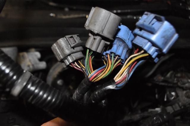

[IMG][/IMG]
These Are The Harness's On The H22A

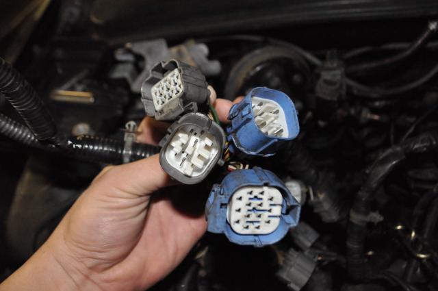

[IMG][/IMG]
