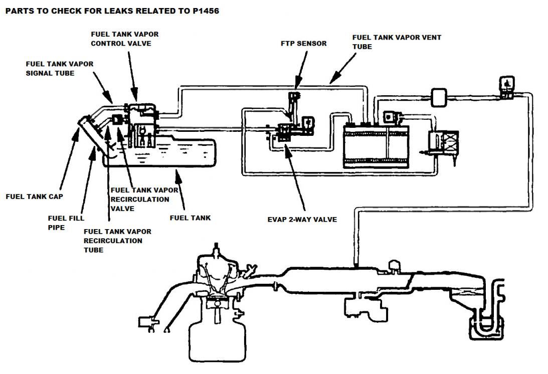

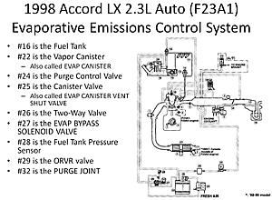

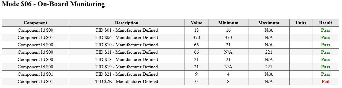

I’d appreciate any help in how to find the meaning of an OBDII Mode $06 CID $01 TID $2E. Does that refer to a specific part that was tested by the ECU/PCU? This is from a 1998 Accord LX 2.3L automatic. This car currently has the CEL set and a P1457 code. It got that after 50 miles of driving after replacing the emissions control two-way valve, which was replaced due to a P1456. I am planning to change the evap canister vent valve to try to fix the P1457, but would really appreciate help with the Mode $06 info. Car has 242K miles on it but still runs well.

Mode 6 is the self diagnostic checks the PCM does. I'm pretty sure these are called readiness codes.
From a quick web search is the $2e is the PCM commanding the EVAP system to purge.

Thank you for the help. My unsuccessful web searching found what looked like a need to purchase a data subscription for Mode 6 info, which may be worth it, but that remains difficult to tell. I have not seen any positive user reports, just marketing info. I tried searching again and got better results, including info similar to what you provided.I found a document named
GlobalOBDVehicleCommunicationSoftwareManual_EAZ002 5B43.pdf
It appears that this is a percentage, $2E EVAP_PCT (%) COMMANDED EVAPORATIVE PURGE (%). I wonder what the numerator and denominator are in this percentage. Based on my prior post, It looks like the minimum value is 8, which I take to mean 8%, and my car scored 0% and thus failed.
Much of the earlier web searching indicated P1456 must pass before P1457 can be tested. I’ve seen these at times described as P1456 indicating a large leak and P1457 being described as indicating a small leak. Alternatively I have seen P1456 described for my 1998 Accord LX 2.3L auto as indicating a tank side leak (between two-way valve and tank) and P1457 as a canister side leak (between two-way valve and purge control valve). This design was supposed to help isolate failures, but web searches suggest that it turned out otherwise, and two-way valves seem to have been engineered out of the design. I was hoping mode $06 would provide additional insight.
Replacing my two-way valve did change things from P1456 to P1457, so I may have had a large leak and now have a remaining small leak. Since I have ordered the Canister Vent Valve, I will go ahead and replace that, at least it is part of the canister side description of P1457. Perhaps I should have also changed the bypass solenoid when I changed the two-way valve, but that is more expensive than the two-way valve plus the Canister Vent Valve.

I found an interesting document named GlobalOBDVehicleCommunicationSoftwareManual_EAZ002 5B43.pdf. The document provides a description of EVAP_PCT. It seems that EVAP_PCT shows the duty cycle of the purge control valve, where 0% indicates no flow.
Why would I have a 0% duty cycle for my purge control valve?

After clearing the code and two drive cycles, I have another P1457, but this time there are two Mode $06 failures.
I noticed that the Component Id is $00 for the TID $18 issue (it was CID $01 for TID $2E). The helpful document lists a few possible descriptions of TID $18, so which one applies to my 1998 Accord LX 2.3L Automatic?

Be careful with the "failed" test, because you might not have completed the entire drive cycle to pass the test. I don't know the criteria to pass the test.
Work on the P1457 first, since you have the code. Then worry about the $18 later. $18 looks like the secondary O2 sensor heater circuit from a very quick google search.

Or maybe I had a large leak that was fixed when I replaced the two-way valve, and now I have a small leak. Perhaps it is time to obtain a smoke machine and figure out how to use it. Is there a smart choice amongst tools on the market? Where would I find the green cap service port on my car?
