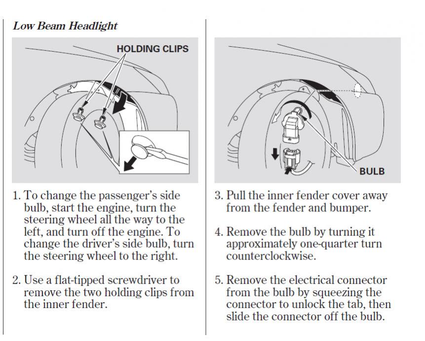

I have searched but can't find the answer. This is probably a simple thing to do but the owner's manual isn't very clear. I need to replace the low beam head light bulb on the drivers side of my 2004 Honda Accord EX/AT. The only thing the manual tells me to do is turn the wheels to the right in order to 'get to it'. Okay, I understand that. If I take the fender well cover off will that allow me access to the bulbs? Someone on ask.com said you have to remove battery and then...just reach in and unplug. Is there an easy way to gain access to the bulb? Thank you, in advance, for any help.

Different years, sometimes it's blocked by the battery. But for 2004 I think you do have to push open the plastic inner-fender liner & reach in that way. You probably have to remove a couple fasteners - some combination of screws & those stupid little push things.
As shown in the owner's manual, turn the steering wheel to the right, then use a small flat-head screwdriver, pry the two plastic clips off. It helps to spray the plastic clips first with something like WD-40, to help remove any built up grime and dirt on the inside of the clips.
Thank you for the help. It took me longer to go purchase the bulb than it did to replace it. I did as described above...removed two of those stupid little push things, pulled back the inner-fender liner (which I thought was plastic but it feels like some type of rubber material) just enough to get my hand inside, located and removed the burned out bulb, inserted new bulb, put the inner-fender liner back in place and said..."See, you CAN do it."
