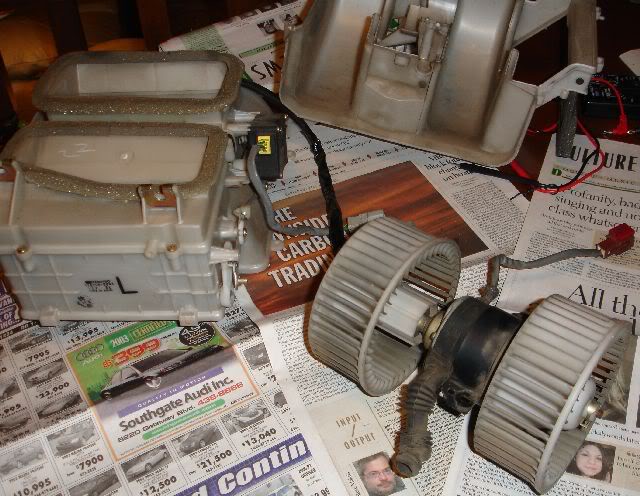

Well, I've been a busy little beaver.
I hooked the fan motor directly to a fully-charged12V motorcycle battery and the motor didn't even blink.
The fan does not seem to spin as easily as it should for a fan. I don't want to be too technical, but I think it's AFU on the inside.
I can not imagine what the local Honda dealer wants for a new one - probably several hundred - so I guess I'll be looking for a salvage motor tomorrow.

The brushes on the blower motor are worn to the point they've tumbled in the brush holder and are binding. It's not repairable and only fix is a new or used replacement motor. Replacements are expensive for the 90-93 Accords. I think the OEM motor is over $200. Check some of the parts links on this site for replacements, ebay, or car-part.com for a used part. Used parts are getting a bit long in the tooth to be reliable, and it's a pretty good job to remove the blower as I'm sure you've found out.

I used a "rebuilt" unit for a 90 EX several years back that only lasted 1 yr. I think it was a Carboni part, but it's been a while and I'm not certain. The reason the price is high is the OEM replacement is pricey, $200+, so aftermarket set their prices accordingly. I actually managed to rebuild one of these motors (believe me it's not worth the trouble), and it only lasted 6 months. Honda OEM is probably highest quality part to insure not having to repeat the job.
