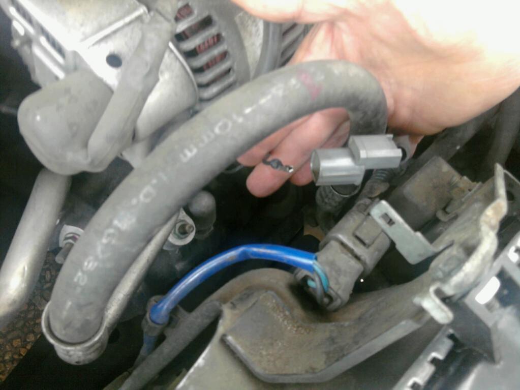

Hi,
Just trying to help a friend. He has a 1996 Accord LX 4-cyl. He had some issues with A/C (when he turned A/C on, it was blowing nothing but warm air. He took to a "mechanic" and mechanic disconnected somthing or removed something, I wish I would have seen what he did (see grey wire wire coming from a compressor, I guess and connected directly to a connector from the harness(see picture) and now when he turns A/C on, it constantly on. Since neither myself or him don't have a service manual, I am trying to figure out what part this mechanic disconnected or removed. If ayone can compare the attached picture with your accord, and see if anything is missing at the picture, please post it here. It would be very much appreciated.

Its kind of hard to see what the mechanic did. I'm guessing that he somehow bypassed the compressor relay.
The wire that leads to the compressor goes to the compressor relay. That relay is mounted on a bracket (along with another relay) bolted to the driver's side fan.

If you don't mind, would you please post the picture showing the exact location and then I can check if that part exist on my friend's car.

You were 100% correct about the compressor relay. I checked another Honda Accord and sure enough, the compressor relay is missing on my friend's Accord. So, if the relay is defective, A/C will never work unless the relay is bypassed.
