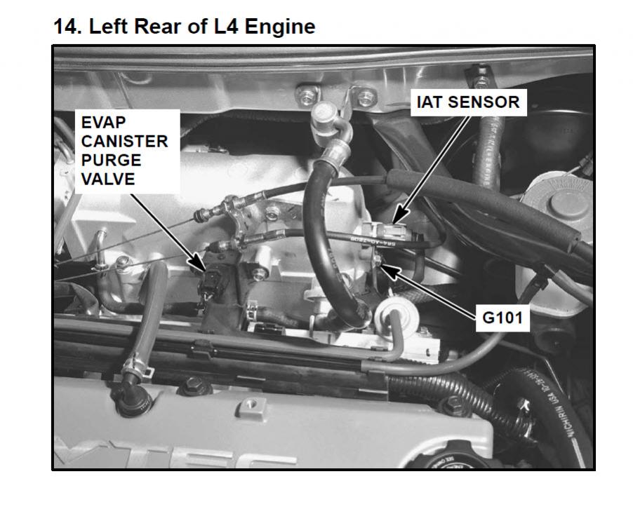

Check the ground connection and wire at G101. See pic. Make sure it is clean and tight and wire is not damage.
Attached Thumbnails HELP!! 6th Gen Accord Intake Manifold Gasket Swap Now Can Will Not Start-6th-gen-accord-ecu-ground.jpg

G101 is for:
DLC (BRN/BLK), EGR valve and EGR valve position sensor, IAC valve, Immobilizer receiver unit (BRN/BLK), PCM or ECM (PG1 and PG2 are BLK; LG1 and LG2 are BRN/BLK), PGM-FI main relay, Radiator fan switch, Shift control solenoid valves B and C, Transmission range switch, VSS (M/T), VTEC oil pressure switch (BRN/BLK)
Shielding between the PCM or ECM and these components (all have BRAIDED wires): CKP/TDC sensor, Countershaft speed sensor (A/T), CYP sensor, Knock sensor (LX, EX), Mainshaft speed sensor (A/T), Primary and secondary HO2S
You car will have starting problems without it, as the PCM/ECM and main relay uses that. The PCM/ECM and the main relay affects fuel injection and fuel pump control. Immobilizer also uses G101.

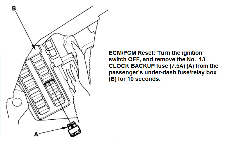

1. Check that the IAC valve connector terminals and wiring are not damaged.
2. Make sure it is firmly connected to the IAC valve.
3. Reset the the ECM/PCM either with your OBD reader/scanner or pulling the passenger under-dash Fuse No. 13 (7.5A) for ten seconds.

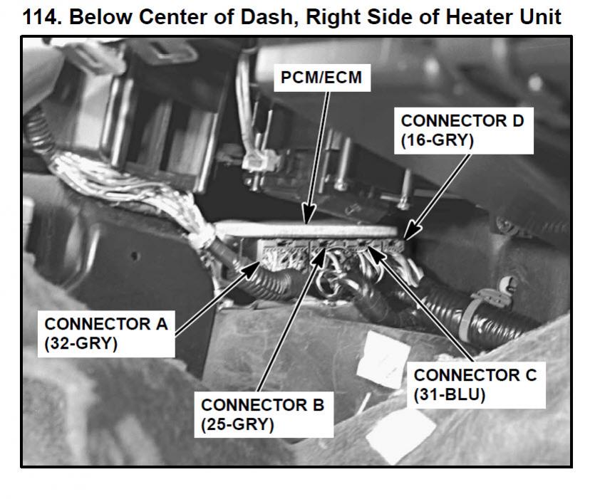

To do that you would disconnect the ECM/PCM Connector B (25P gray connector). Then check for continuity to body ground on the Connector B terminal B23. There should be no continuity to body ground. If there is continuity to body ground, there may be a short in the Blk/Blu wire that goes from the IAC valve to the ECM/PCM.
To get to the PCM's connectors, you only need to remove the one plastic clip on the passenger side carpet and pull back the carpet on that side. Connector B is shown in a different photo I've attached.

Attached Thumbnails HELP!! 6th Gen Accord Intake Manifold Gasket Swap Now Can Will Not Start-iac-valve.jpg   HELP!! 6th Gen Accord Intake Manifold Gasket Swap Now Can Will Not Start-1998-2002-accord-ecm-reset.jpg   HELP!! 6th Gen Accord Intake Manifold Gasket Swap Now Can Will Not Start-ecm-pcm.jpg

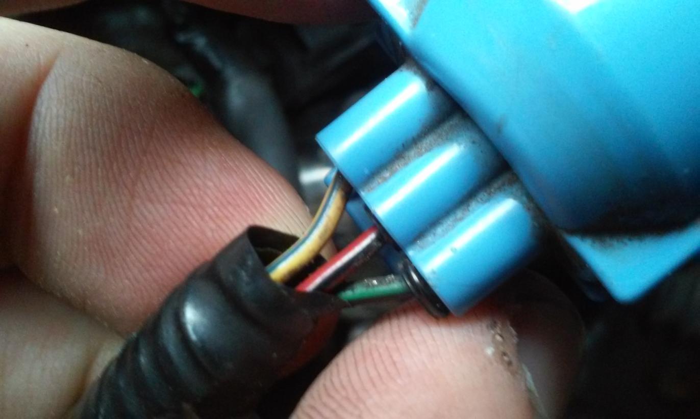

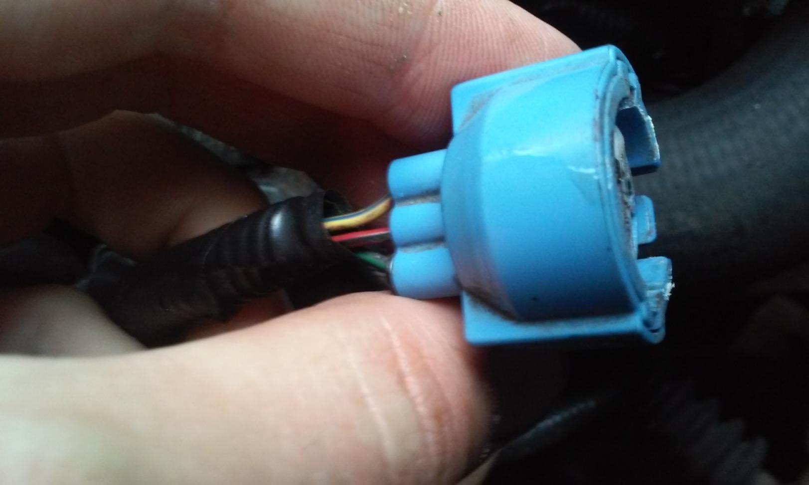

So, it doesn't look like the terminals themselves are damaged but the connector doesn't look great. I'll attach a picture. The wiring APPEARS to be good, but I think there's more going on there than I can see.
1. Terminals look good
2. Definitely a firm connection
3. Resetting the PCM was my first thought as well. Did that with my OBDII but the code comes back on shortly there after. Actually, it's interesting, if I disconnect the IAC electrical harness while the car is running, the idle bumps up to a constant 2000 RPM with no surging. Then I'll reconnect the harness and it stays at 2000 grand till I erase the P1519 Code and immediately it drops and begins surging again. Don't know if that might be pertinent information.
4. Done
5. Yes, there is voltage. It's about 3.7-3.8. What sort of voltage should I be looking for?
6. This is where I'm getting confused. I'll post a picture of the harness I've got, but none of these wires look black to me. Are you describing a connector different than the one for the IACv?
Attached Thumbnails HELP!! 6th Gen Accord Intake Manifold Gasket Swap Now Can Will Not Start-20140727_110512.jpg   HELP!! 6th Gen Accord Intake Manifold Gasket Swap Now Can Will Not Start-20140727_110506.jpg   HELP!! 6th Gen Accord Intake Manifold Gasket Swap Now Can Will Not Start-20140727_110448.jpg
