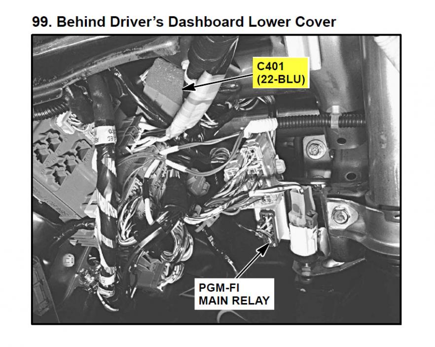

Attached is a partial picture of the Immobilizer circuit. The Immobilizer receiver harness appears to run from the steering column area, along the underside of the driver's dash to Connector C401, a 22-P Blue connector, which then runs to the harness connected to the PCM/ECM.

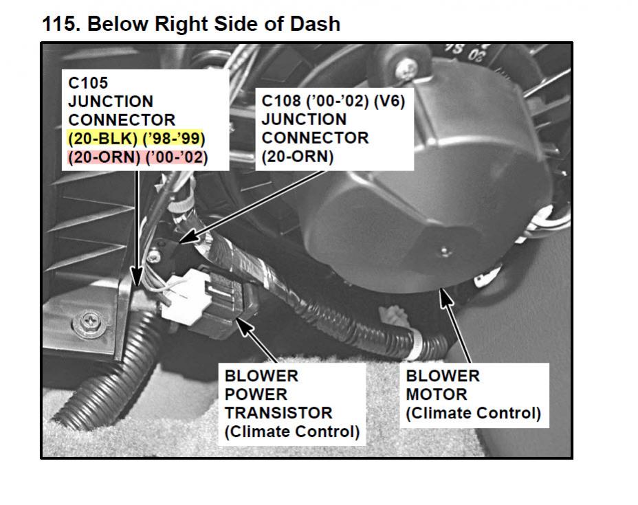

There does appear to be a difference for the brn/blk ground wires from the engine harness(for a V6 99 vs. V6 01) going into the junction connector C105 (located inside below the right dash area); however, I don't think that would cause the problem with the Immobilizer.

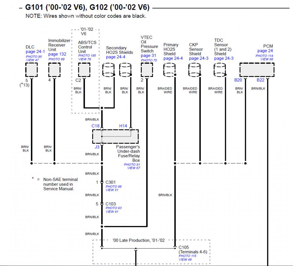

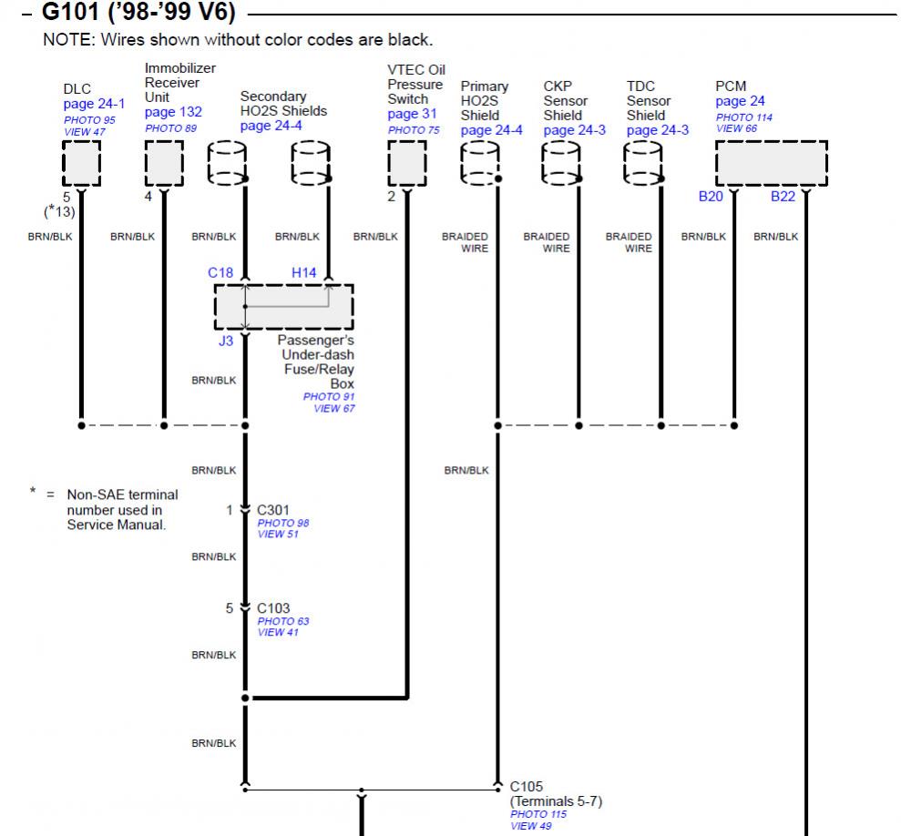

For the 01 V6, a ground wire for the ABS/TCS control unit is added going into the C105 junction connector.
