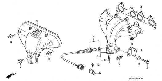

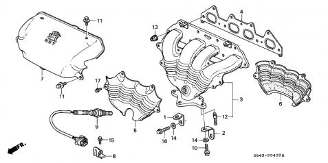

So now the big difference between the engines is the exhaust manifold. Which of the 2 pictures looks like your manifold?
Attached Thumbnails HELP with Check Engine Light-99-exh-man.jpg   HELP with Check Engine Light-99-exh-man-ulev.jpg

It looks like i have the one in the second picture you have attached.. would an aftermarket header be a solution for this?

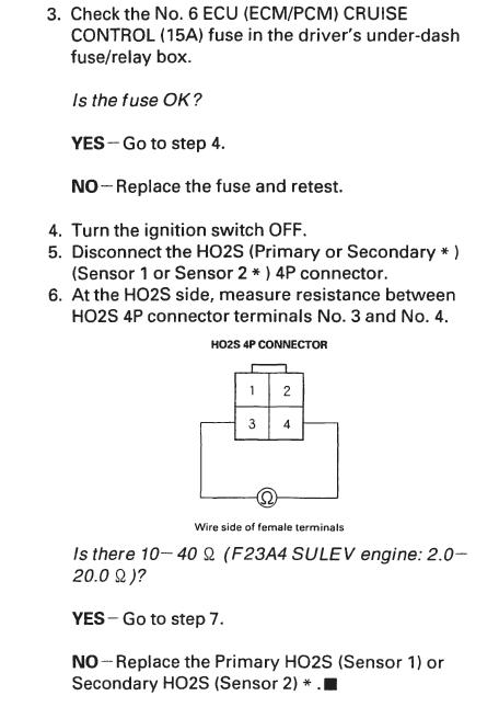

Old Nov 8, 2012 | 06:07 PM
Drivers side underdash, #6 fuse....pretty sure you are not the SULEV but they have another in the pass side underdash #6 as well.
Step one of testing the p0135.
Attached Thumbnails HELP with Check Engine Light-6th-gen-p0135-test-4cyl.jpg
