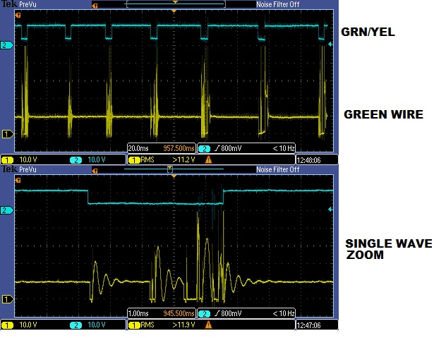

Here is a pic of the grn/yel wire (ICM to ECM) = top wave (blue trace)
and the green wire (ICM to COIL) = lower (yellow trace)
Engine cranking, no start.
Do these waves look like they should? I think the top (blue) wave is good but not sure about the green distributor wire wave (yellow wave).
The voltage is set for 10v per division in both screens.
Time= top screen 20mS/div; lower screen is 1mS per division.
pulse width is about 4.25mS
If you look closely you can see that the ICM/ECM (grn/yel) wire is not being pulled completely to ground, only down to about 4v. is that a problem that would cause the no start condition?
Again, this is a 1995 Accord 2.7L V6.
No stored codes.
Any suggestions where to go from here?
Thanks a LOT!

I may have made a mistake on the voltages to the yel/grn wire between the ICM and ECU. The shop manual I have says the voltage should be 12V when the key is in the II position and engine is not running. Then you will have pulses (square waves) when the engine is running.
The yel/grn wire is at A11 on the ECU. The A connector has 26 pins with one wire missing. The top row is numbered 1-13 and the bottom row is 14-26. You may want to repeat this test at the ECU on pin A11. Also try the quick voltage test.

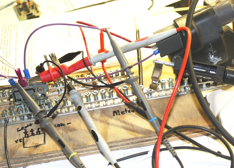

After I got an understanding of the ignition circuit I made a test jig to test the ignitor using a bench power supply and signal generator to simulate the ECM signal. The ICM tested good (all of them). Then I added the coil and a spark tester to the circuit and was able to simulate spark.
The only time that I was able to replicate anything like what was happening was when the current was turned down, causing a voltage drop.
I believe that my problem is in either the power supply wire or the coil ground (that is, unless the coil that is in the car is defective -but I believe it's OK since I tried a few different ones with the same results.
I'll post the results when I find the problem.
Thanks again for your help.
Here is a pic of my test jig. Not pretty but very effective!
