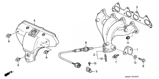

Here's the exhaust manifold for the normal engine (F23A1)
Sensor is #6
