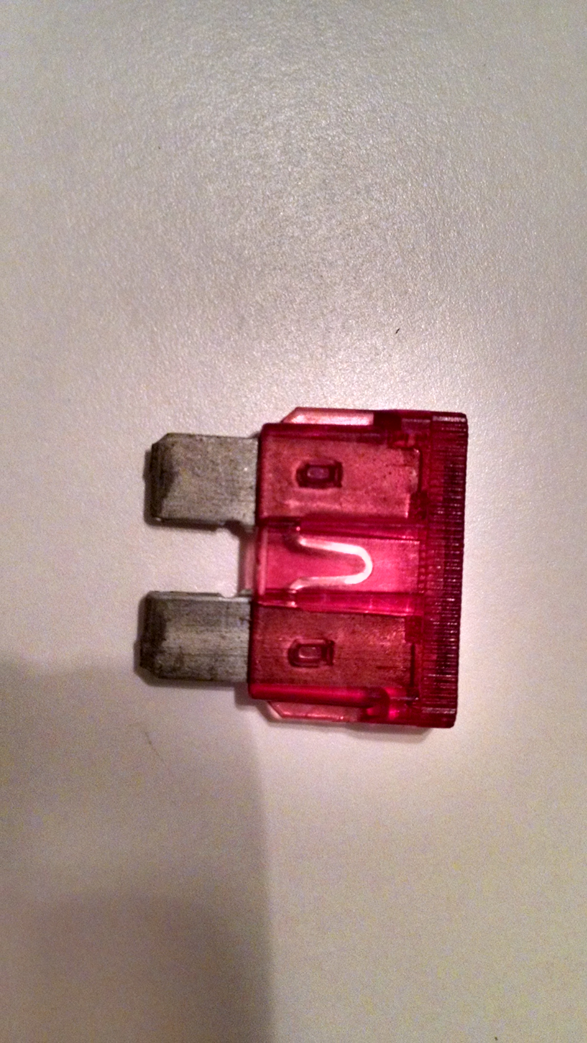

Some additional information. The fuse for the ECU looks good. I've also attached a image of the OEM on the TCU
Attached Thumbnails HELP! Replaced 1990 Honda Accord TCU Now Car Won't Start-img_20151011_195119466_hdr.jpg   HELP! Replaced 1990 Honda Accord TCU Now Car Won't Start-img_20151014_204221873.jpg

Since the Check Engine Light stays on most of the time and the car doesn't start, you should jump the service check connector as I previously mentioned to try to get the trouble code(s).
Issue may even be due to a faulty ECU. A faulty TCU generally won't cause the car to not be able to start; but, a faulty ECU can cause it to not start.
Try to get the trouble code(s) first.
