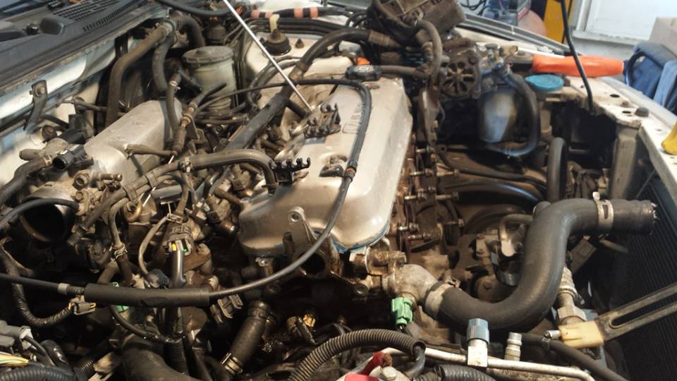

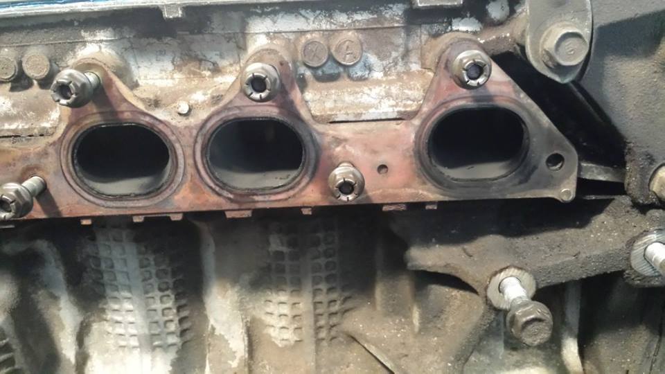

Thanks Roader and Jim for your guidance. your input is greatly appreciated... I've already started tear down. so far one exhaust stud is busted. nothing else so far.
Currently I'm to the point of pulling the timing belt, I've got the tensioner loose and all the way backed off and I can slide the belt off the gear but I'm wondering about getting it back on...
Roader, supposedly the timing belt was done around the 120k miles, it just turned over 170k belt looks good to me, but lil brother (more exp. with belts than me) is gonna come check it out tonight. If it needs it even slightly, that 20bux will get spent. If I get a better view at the waterpump I'll make that call then.

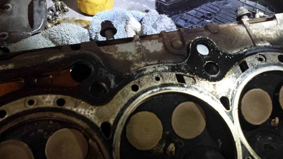

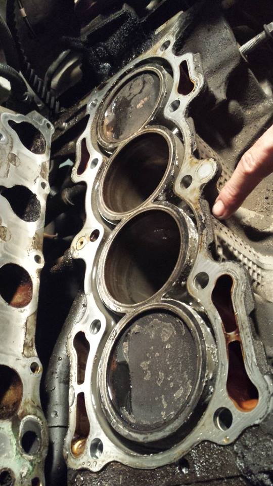

Got the head off. I'm calling it a night... I feel far older than I am.
anyhow the results...
thoughts?

I couldn't definitively tell where the coolant-to-combustion seal was bad on my bad head gasket, even knowing the results of the leakdown test. The head looks eroded where your finger is pointing but I can't tell for sure by looking at a pic. That area only needs to seal 16psi or so of pressure from the cooling system. It's cylinder sealing that's critical.
Is the head flat? Aftermarket or OEM head gasket? I found a Fel-Pro on mine and both the block and head were flat. I could only assume that whoever did the job before didn't do it right (torque/cleanliness/both) because the new (Fel-Pro) gasket sealed up just fine.

You'll have an easy job replacing that broken stud with the head off. It's the same one that broke on my F23. I wasn't able to get the old stud to budge so I just drilled & tapped through the old stud.
