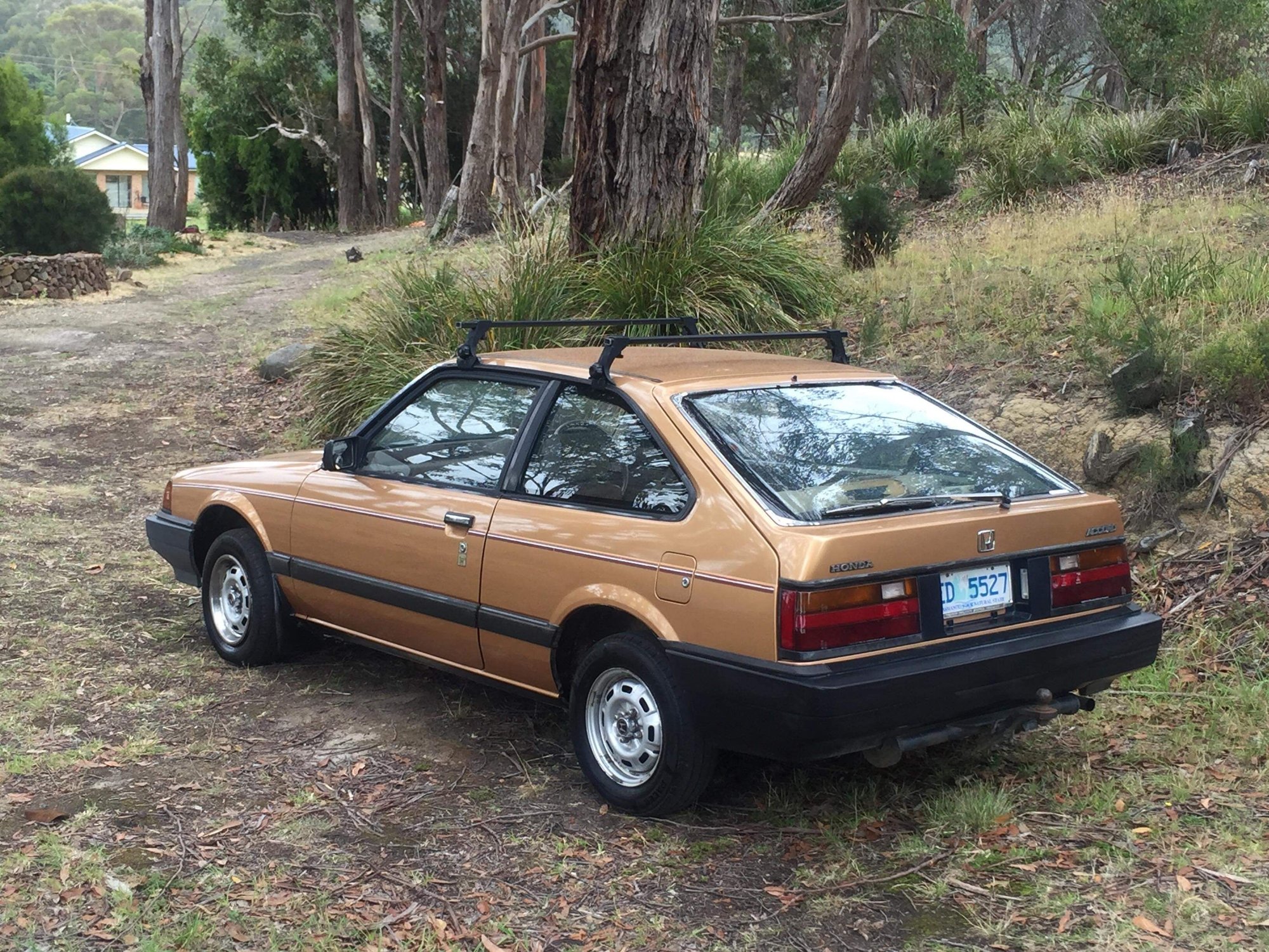

Hi there! I need to stop my car jerking and bucking, it feels like the fuel is being delivered unevenly as it is much worse at accelerating than cruising(worse under 80km /h )Feels too scary to drive at the moment. Tried a carburettor cleaner spray but it did nothing. Just had the head re done so need some help as my mechanic just said he didn’t know what it was after sitting in his yard for a few months. Any advice appreciated, cheers Allison.
