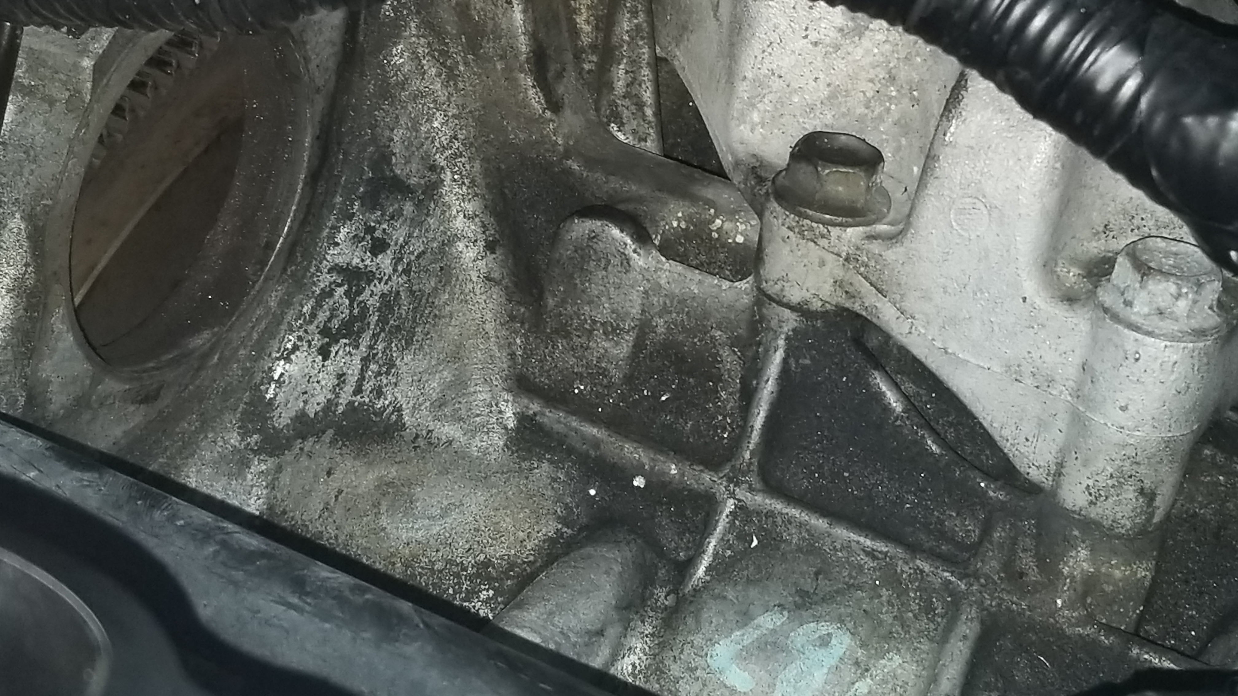

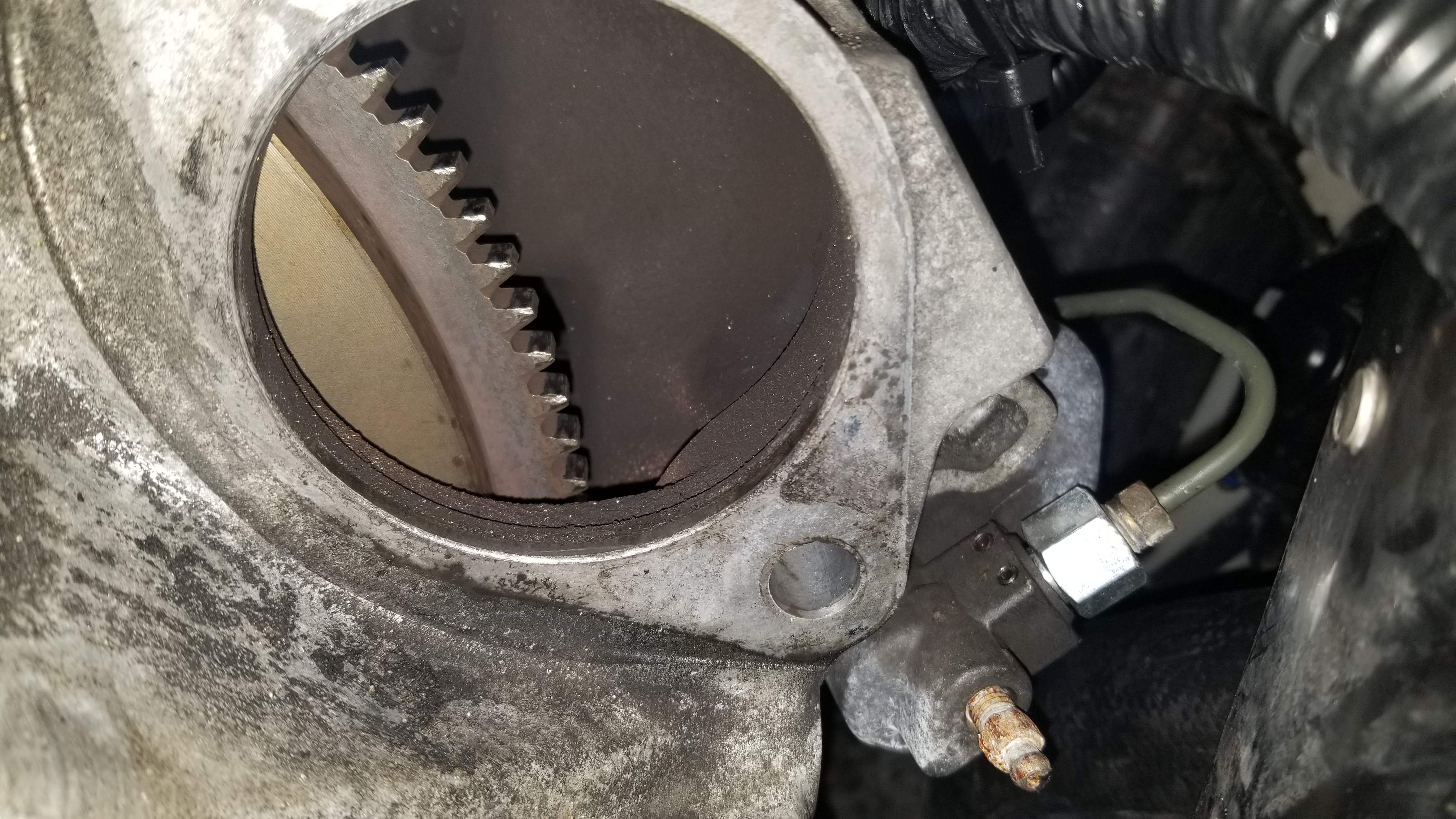

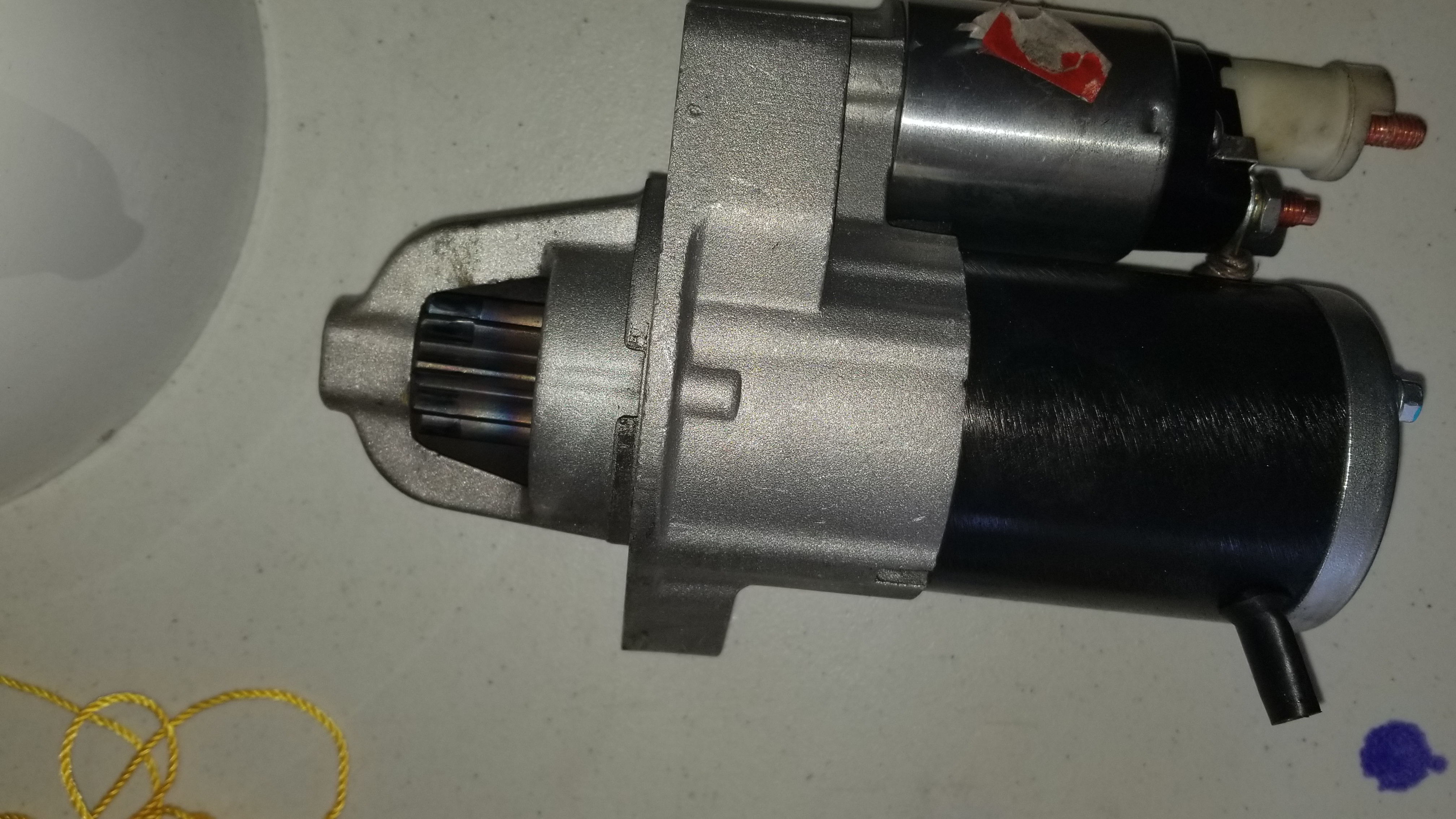

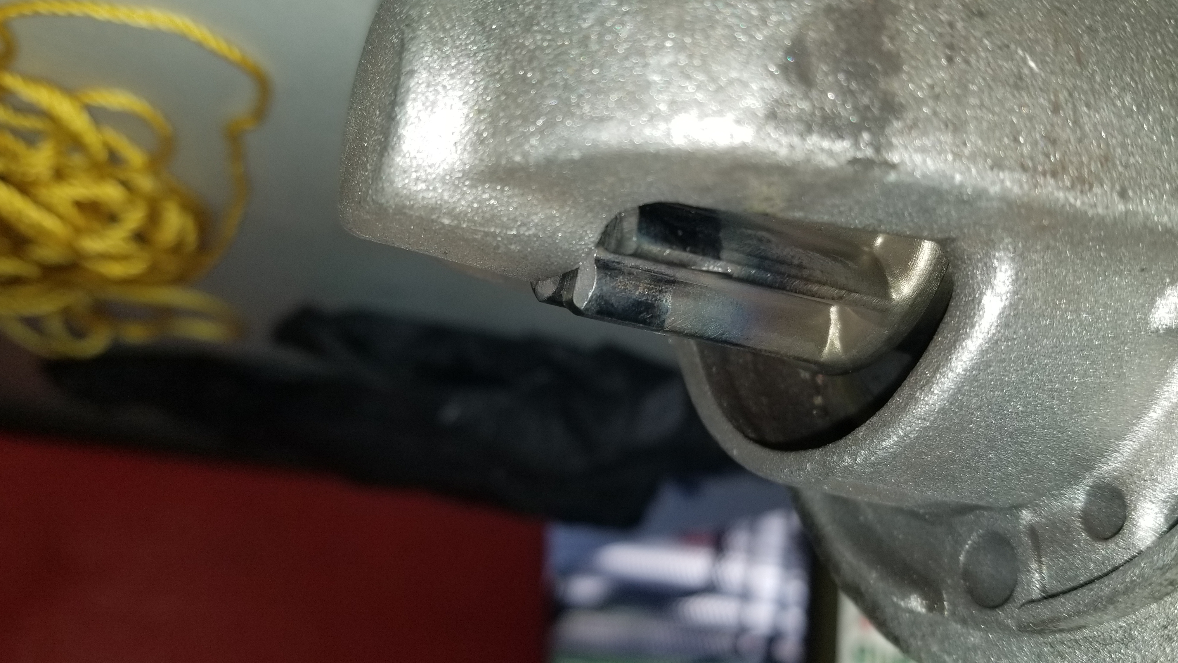

Thanks for the reply, the check engine light is from an O2 sensor. Just to be sure I checked this morning also. I went ahead and pulled the starter out, I inspected it before I pulled it out (the best i could in that tight space) and it appeared to have a nice even seal. When un-threading the bolts they didn't appear to fight me or be pulled to one side or the other. As far as i can tell it was on straight. I guess my plan is to return it to autozone and ask if it was supposed to come with shims or maybe i should upgrade to the next model...not sure what to do at this point. I am including a few photos of the flywheel and starter. What would you do next?
Thanks!

You may have a bad starter. Take it back and go get another. I personally don't use that brand but you are in a bind. I buy from advance auto. I rebuild mine. They don't come with shims
After you get the new one make sure you take off the manifold. You will have a lot of space to do what you need.

Your starter confused me because I have an 07 accord 4cyl manual and I don't have the solenoid separate. Mine is all one piece. Usually you see your type of starter in a 6cyl. But you have the correct one
