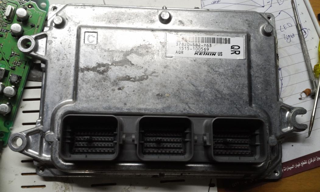

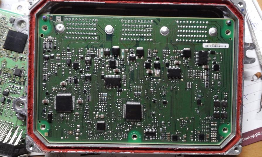

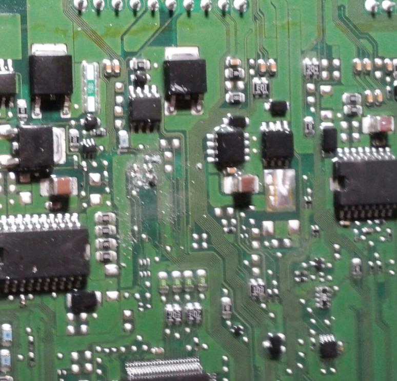

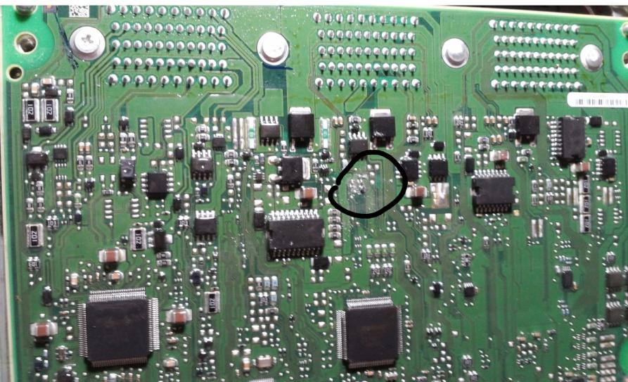

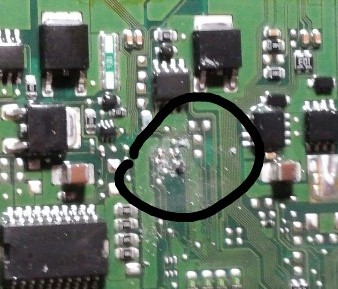

I have a 2013 Honda Accord 9000 km, which was in an accident mainly the front drivers side was damaged, its a "button start" and it will not start, no noise when trying to start, it has a fully charged battery. I checked all wiring, which looks good, checked key remote security, detecting key remote light, lock and unlock, which also all works fine. Then I open the ECU, I can't see one IC or resistor, I'm not sure which IC or Resistor it is here because I can't see IC or resistor number, I would appretiate if you can have a look at the picture I will post to see if anyone knows what this is ????

Your images with that area you’re referring to is kind of small and not clearly focused around that area of the circuit board. From your pictures, I can’t even tell if there was any SMD (surface mount device) component there before or if those are just solder joints for a component on the opposite site of the board.

Yes the indicator lights on when I start/stop button, and when I press the start buttom the key remote detecting light is going off. There is not any error message displaying in the information display. No not any blinking immobilzer system indicator when I turn off the switch then blinking. I seen that solder and small board wiring and it looks like there is something there, and when it was damaged the battery blasted, and I seen the battery acid over the wiring and on the PCM, I checked all the wiring fuse and everything is good.
I also scanned my car and its showing me one code ( p16f6), I have never seen this code before, and this is my work, it was my left front driver side which got the damage and this is also where my PCM and battery is located. yes Im in Saudia Arabia Thanks

The PCM may very well be damaged from the battery exploding. The attached pic. shows the location of the PCM for the 4 cylinder. Although, that code looks to be a problem with the PCM, check the 10P connector going to the transmission range switch as well as other wiring connectors going to the transmission, which are on the same engine main harness connected to the PCM and nearby.
Your PCM Honda part number in the picture from your first post looks to be a different part number than for U.S. models. So, trying to import a PCM for the U.S. models has a risk of it not being fully compatible.
