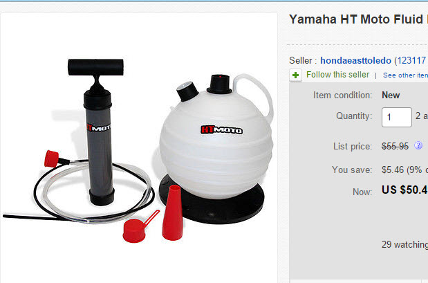

Hello,
Has anyone used an oil vacuum extractor before,
For 1999 - 2001 Honda accord v6.
Does this work effectively for an oil change. Is there anything else I should know for an oil change with this device.
Will this work for transmission fluid drain and refill.
Thank you.

I use a Pela 650 to change the oil on my 2001 Accord EX with the V6 engine; it works great.
FWIW, I have been using the oil extractor since the late 1990s; what is interesting is when I buy a used car (such as when I bought the Accord which had 114,000 miles on it), the oil which comes out of the Pela following the first oil change is fulll of crap and other sedement which does not drain out via the oil plug. After a few oil changes with the Pela, the oil comes out as pretty much just oil (with no extra crud).

Will the outside diameter of the oil vacuum extractor, fit for both the oil filler tube.
Also, would this device work for the transmission fluid also.
I need to attempt this method, since my oil pan threads are stripped and kind of weak.
Thanks for your time and responses.

I suppose it depends upon the unit you buy. The Pela 650 has two different diameter tubes; the large tube fits the V6 in my 2001 Accord, and pretty much every other car I've used it on except two (a 3.8 liter engine in a 2003 Grand Caravan and a 2.0 liter engine in a 2009 Mazda3; the smaller tube worked for both of those).

It was not stated that the threads were bad.
The threads are bad or nearly stripped on the oil pan portion of the plug hole.
I want to try this vacuum method for oil change. Since the car is 16 years old, V6 Honda accord. 1999 Honda Accord with 165000 miles
Has anyone had been able to use an oil vacuum extractor for 2-3 years.
Does the hose going into the oil filler tube ever break or fall apart.
Thanks.
