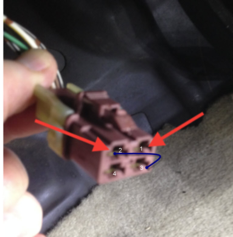

redbull-1 ... OK - I am not able to tell exactly which lines go into which holes of the connector, I am guessing because of my 60 yr old eyes & associated glasses.....but I tried every connector slot with every other one. Nothing lit the brake lights. But when I connected the two holes indicated in the photo I have attached, I definitely heard a solenoid kinda sound from under the dash area. I checked and I still can't shift out of park with those two holes connected - even with the key in the "run" position. So thats where I am now.
Based on what I have read on the 'net, I need to check the brake light failure sensor next. But would that also keep my shift lockout from disengaging?
Again, thanks for your help!!!
MarkB

The Wht/Yel wire cavity is at terminal no. 2 and the Wht/Bk wire cavity is at terminal no. 3. (See attached photo - Click the image to enlarge).
Check under-hood Fuse No. 47 (20A).
If fuse is good, check the voltage reading on the Wht/Yel wire cavity terminal no.2 at the brake light pedal position switch harness connector.
The brake light failure sensor would not affect the shift position interlock circuit or the high mount brake light.
Afterward check your bulbs too. The bulbs for the left and right are dual filament bulbs, one filament for the tail light and another for the brake light.

Next, I jumped your numbers 2 to 3 with a paper clip .... no brake lights at all, and I could not shift out of park (with the key in run position, but engine not running).

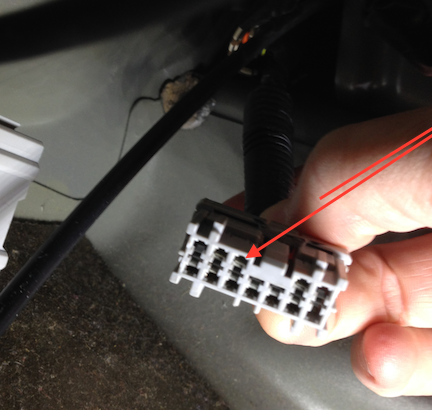

redbull-1 ... I checked G601 - it looks alright. I unsrewed the main screw and screwed it back in - all uneventful, and no corrosion or badd connections apparent. A have attached a picture.
So I checked connector C554, behind the trunk lining towards the top. I checked every socket with the brake pedal pressed. The only one that registered a voltage is the one indicated with the arrow in my attached photo. (11.78V, which is what I have across my battery terminals right now - it starts and runs with that voltage). It appears to house an orange wire. I'm assuming some other wires should have a voltage as well, right? So it appears I have a problem between the fuse box and C554?
Thanks again for your continued help!
markb57
