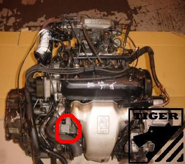

90-93 accords DO NOT HAVE VTEC AT ALL. The ex has the f22a4 engine. all cb7s have f22a engines...none of them are vtec!!!!!!!!
The way you can tell what accord you have is by popping the hood and looking at the engine code. look at the pic I posted in the pic that is the location of the engine code
ALL CB7 ACCORDS DID NOT COME WITH VTEC...not even the ex.
I don’t have time to read all this thread I will come back when I can to give my input
Attached Thumbnails HONEY DO LIST- Posted by a non-mechanic wanting to learn.-engine.jpg
