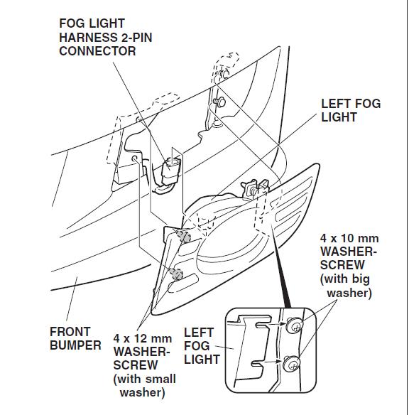

Been wrong before and will be again, didn't think the '01's had factory fog lights, were not listed in my manual and didn't see them in the online Honda Dealers websites.....but there are dealer add on's....If it is a dealer add on try this. Notice the "outer" two do not have to come all the way out, only the "inner" two. Then you will need to re-aim the lights.

I'm like 95% sure that's what they look like! I didn't drive it today so I can't go look but thank you! I'm sure I can figure it out now! I'm replacing headlight assemblies Sunday so I'll prolly mess with fog lights then to

Here are the installation instructions for the 4 cylinder. If your EX is a V6, let me know. Although installation requires removal of the front bumper, on most Hondas, lenses replacement does not require bumper removal. On some Hondas, you can remove either the engine splash shield or turn the wheel to one side (depending on which side is being replaced) and then opening a inner fender plastic cover and try accessing.

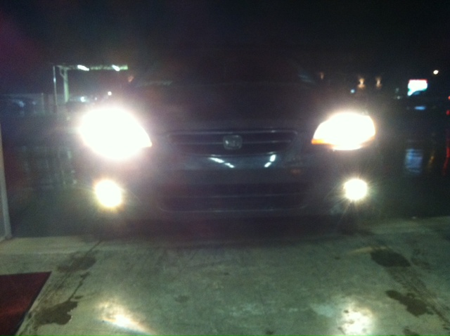

i just couldnt wait, its a curse.
