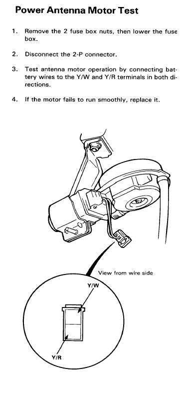

i'm tackling same job...... it's a power antenna.... where's the power you have to disconnect?? did i miss that part of thread??
Old Jul 2, 2012 | 12:54 AM
Here some pictures with some instructions regarding the motor.
Attached Thumbnails  How do you get a power antenna out- 88 Acccord?-power-antenna-motor-location.jpg    How do you get a power antenna out- 88 Acccord?-power-antenna-motor.jpg

YOU GUYS ARE THE BEST!!! ESPECIALLY YOU "DESERTHONDA", FOR TELLING ME ABOUT THE CLIP! thanks to you guys, the job is done!. btw, the car is a 1988 accord lx, owned by a 104 yo woman, never seen winter, 46k on it, made in USA. i get a kick out of the pop up headlights
