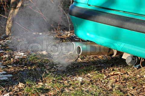

97 Accord Ex with 204k. Which is part of the reason I'm double checking this. This just seemed a bit more than typical and the smell worried me. Its not what we think of when a car has a blown head gasket but it was consistent, white, smoke with the smell of "burning water". I suppose I should drive it more or do a compression test.
It was kinda like this only shooting out cuz the car was at 2500rpm. At idle theres no smoke which is why it caught my attention (higher rpm and more strain on the engine causes coolant to leak in)
From my experience it's hard to tell whether or not its coolant or the usual water vapor.

If you smelled coolant it is most likely from the outside of the engine. I would pressure test the cooling system.

Reservoir froze when it went low; kinda hhmmm. 75% what, 25% what?
I used to do 55% antifreeze, 45% distilled water all year, mixed myself.
Now I just buy the prediluted 50:50 stuff.
Originally Posted by RobinsonRicer
The smoke went out about 3 feet before dissipating.
Its about 35 degrees out.
FWIW, that's no different than my car.
