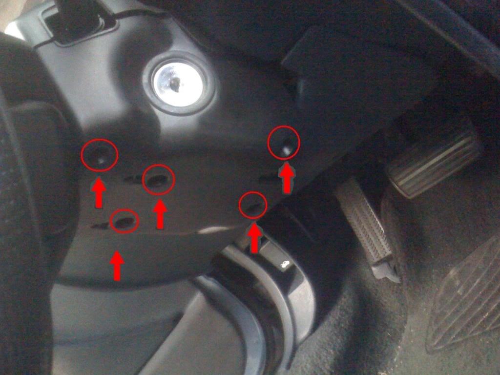

First remove the 5 screws that hold the stering column with a star point screw driver (you might need a ling screwdriver)...
Remove the casing to expose the ignition assembly

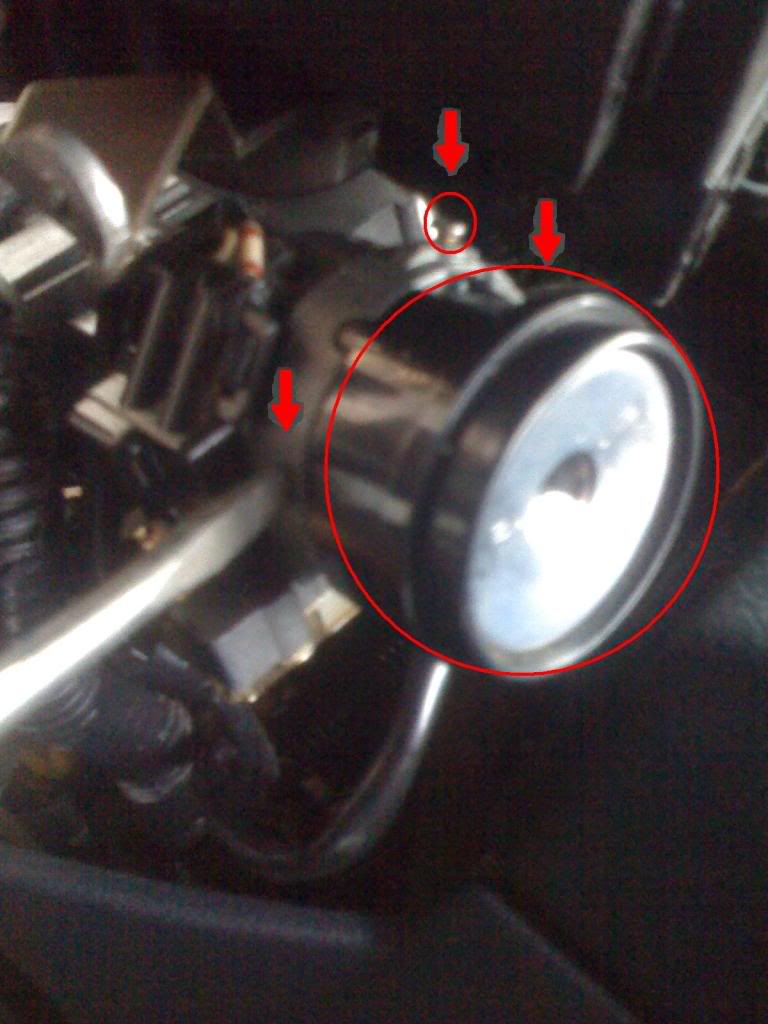

Use a flat head screwdriver to remove the outer shell of the ignition cylinder (black round thing around the turnig part)
Remove the locking screw (I just used a bird beak pliers to back it out because of the odd location " it right by the middle arrow")

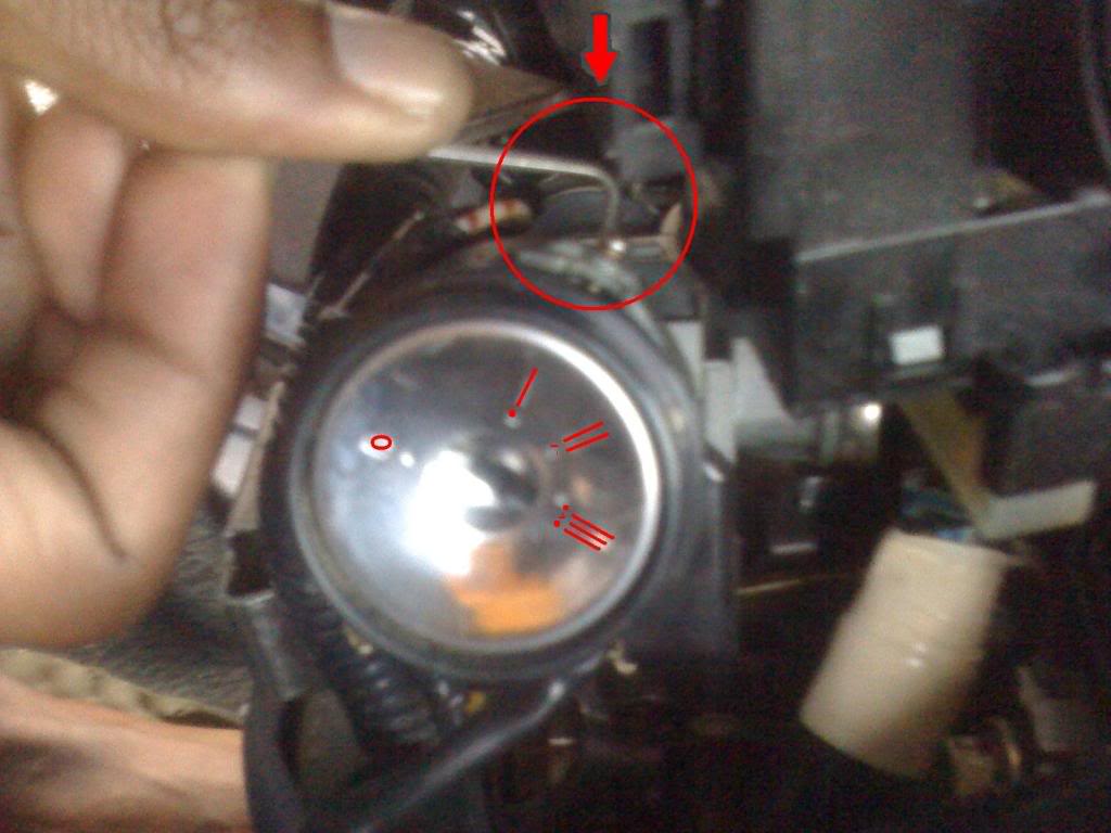

Put in the key and turn it to position I.. (Turn on the ignition... dont start it...)
Use a firm tool to depress the locking pin located behind the lock screw towards the stering whele shaft...
Thought U dont see my key in the ignition U MUST HAVE THE IGNITION ON!!!
while depressing the pin hold the key firmly and pull the cylinder out (rock it a but it should come right out)

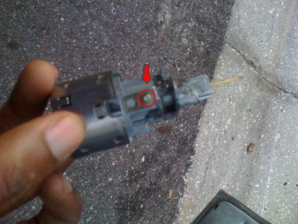

I couldnt get the new one in cause the new pin on the new cylinder wouldnt depress... (when installing the new one leave the key in the on position)...
I just used a set of pliers to pluck it out... then just used the locking screw to hold it on.... dosent really matter tho...
