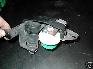

The valve opens/closes via vacuum. The sensor in the EGR valve sends voltage to the computer on how far the valve is open.
A code 12 means the computer is not seeing a proper signal from that sensor in the EGR valve.
So the problem is either with the sensor on the valve, or the vacuum control on the valve.
The easiest test is to follow the vacuum hose from the EGR valve to the controls (drivers side of the engine bay). See attached picture. Make sure the vacuum hoses are not rotted or damaged. Be sure to inspect the vacuum hose that attaches under the controls (you may have to unbolt the vacuum control valve and solenoid). It is held in by one or two 10mm bolts.

I found the EGR Valve it is on the left side of my engine. However I did not take it off because I am wondering where in the heck is the vacuum hose that is not connected. Can someone show me or tell me where it is in my engine?
