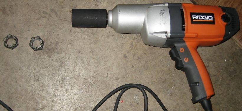

I just got another e-mail from the Ridgid wrench seller. Here it is:
Tony,
I took your advice and used the wrench for longer periods of time and I was able to get both axle nuts off. The passenger side nut came off yesterday after applying the wrench on setting 1 for about 45seconds to 1 minute. The driver’s side nut still didn’t want to come off after a couple of minutes so I applied some more penetrating oil overnight and tried it again this morning on setting 1 and it still didn’t want to come off. I switched the wrench to setting 2, which increases the number of impacts per minute, and then the nut came off pretty quickly. Needless to say I’m much more impressed with this wrench now than before .................. Thanks for your advice!
The Ridgid tool is definitely back in the running!

BTW, here's a photo of the victor and the vanquished sent to me by the Ridgid owner:
