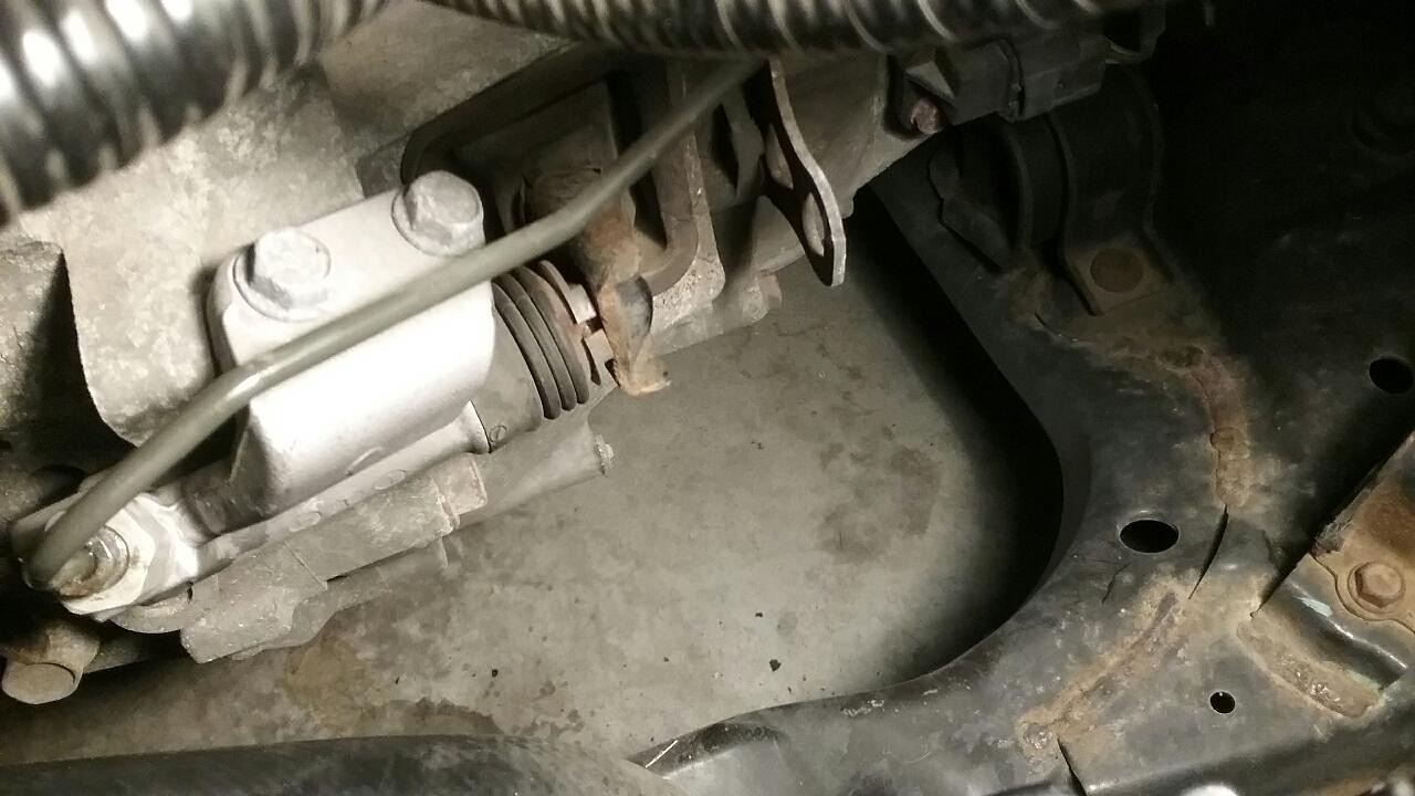

Old Nov 12, 2017 | 09:32 AM
ckharry's Avatar
Joined: Nov 2015
Posts: 4
Default Same symptoms with 06
JimBlake, I have the same symptoms with my 06. You said the throw out lever travel should be about 12mm for the 94'. Do you know what that travel should be on my 06'? The travel is only about 1/4" (6.4mm).
The symptoms started rather suddenly according to my son (driver). We bled the lines / added fluid and I'm confident that is not the problem. As soon as the pedal is touched, we see movement out of the slave.
I am wondering about a plastic piece that I see between the slave rod boot and the throw out lever (immediately right of the boot in attached picture); if it broke and has allowed extra movement (of throw out lever to left, which would allow further clutch engagement) that is the cause of the rather sudden issue, or if something is wrong with master or slave. Of course, this is my 1st time troubleshooting this.
Would appreciate any help!
Old Nov 13, 2017 | 06:57 AM
I got that 12mm travel by measuring a couple cars that I've owned. 1995 Integra, 2003 Accord, 2007 Civic. So it seems like the travel is the same across a lot of Hondas. But that's not an absolute certainty.
That plastic piece looks like it helps lubricate the ball&socket where the slave pushes against the lever. My Integra used to get squeaky, and I had to occasionally put some grease between the ball & socket.
Can you push the lever towards the right side of the car? Compressing the slave piston? If the piston is already bottomed out, that would indicate your clutch disk has worn down and it's time for a new clutch.
