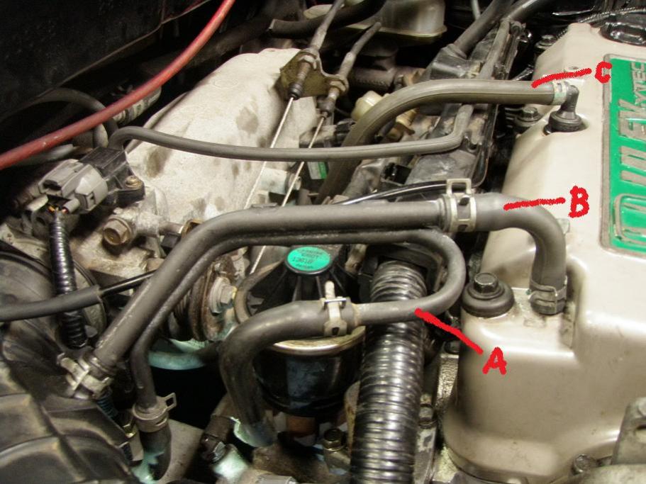

The crankcase vent - there's one connection with the PCV valve & a hose over to the intake manifold.
But the other vent from the valvecover, connects to a metal tube that's attached to another metal tube. One tube is the air vent, the other tube is antifreeze. Make sure you don't have those crossed.

Wow, I sooooo wish that could have been the problem! Thankfully, they designed these lines in a way that, although the tubes are joined, it would be a small challenge to mix them up.
I attached a pic for anyone interested in this possibility.
'A' is a water line, 'B' is an air intake line, and 'C' is the PCV line.
Anyway, Bravo to your thinking, because that is exactly what my original gut feeling was telling me as well, and the first thing I looked for. (These hoses particularly because they are so frik'in close together).
Thank You !!! Any other guesses???

It looks correctly plugged in there in the photo.Is there any water pipes or lines behind the intake back there that could be mixed.I'm just asking,throwing ideas out there,but do not know if there's any that could be connected in a way to have coolant get sucked into the engine and pumped through the system.
I'm really curious myself whats wrong,and best luck finding it.Hopefully its something simple or over looked,nothing serious.

Yeah, I forgot about that candycane bend on the crankcase vent water pipe. (I don't have the 1998 any more)
