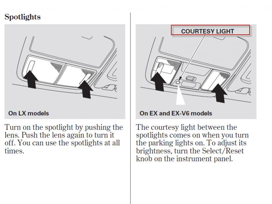

My ambient light works, then doesn't work. I've changed the bulb with no change. The map lights work just fine. It will blink if I tap on the cover, but will not stay on reliably. (03 EX V6).
Old Oct 28, 2014 | 08:22 PM
Are you referring to the ambient/courtesy light as shown in the illustration?

That's the one. The light really helps to see the console at night, but buying a new home-link for $400 is out of the question.
Old Oct 28, 2014 | 09:24 PM
That light consist of an LED and resistor. It may be a solder joint contact issue at the unit or a wire connection issue. You can try to inspect the solder joints and re-touch the solder. Also inspect the 10P green wire connector wire and terminals; terminal no. 1 (Red wire) is the ground source and terminal no. 4 (Red/Blk wire) is the power/voltage source for the light.
