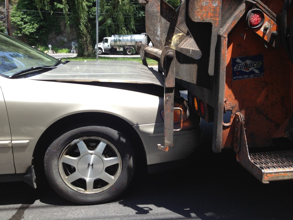

How can the brakes fail without warning and then work just fine after a 30-minute ride on a flatbed truck?
I drove my housemate's 95 Accord wagon yesterday to a meeting. I stopped at a light on a downhill incline in town without a problem. About one min later, traffic slowed down, I was coasting on a flat area of road, foot off the gas, maybe 3 mph. Trash truck in front of me applied his brakes. I applied my brakes about 10' from rear of the trash truck but NOTHING HAPPENED. The brake went clear to the floor and there was no brake! I thought I might just coast to a stop or maybe bump him slightly, as I was only going about 2-3 mph. The Accord bumped the trash truck's rear and buckled the Accord's hood, but there was no damage to trash truck. The hit was so mild that the trash driver got out, came back, and said, "Did you bump me? Oh, I guess you did!" (This he said after he saw the damage).
I paid $150+ to have AAA tow the car home per housemate's preference only to have him drive the car into the parking pad WITH NO BRAKE PROBLEM. He says I'm lying about the brake failure "because the brakes are fine". I know the brakes failed! I just don't understand how they can fail one minute and then work fine 30 minutes later???
NOTE: There were no brake sounds like when your brakes are going out, the road was dry, it was a hot and sunny day, and I wasn't doing more than 2-4 mph.
Also, I'd appreciate your opinion: Should I pay to replace his hood?
While I deeply appreciate the loan of his car, I did not use his car in an irresponsible manner. He says since I was driving it's my responsibility to replace it at his estimated cost of $2000. I want to be fair, but in my mind, replacing his hood is nothing compared to the lawsuit(s) he would've incurred had I been killed or seriously injured, or killed/injured others had this happened at a higher speed. Not to mention I received a citation because I hit a city vehicle, so I’m already going to have to pay a fine and perhaps end up with points on my license. I want to do the right thing, but borrowing a friend’s car that suddenly has no brakes seems beyond the normal level of responsibility one takes on when using someone else's car. What do you think?

...his estimated cost of $2000
If that's the only damage (and a cursory look at the pic shows only hood damage) then scout salvage yard websites for the same color hood. $200 ought to get you one and it's a four bolt job. Probably take a half an hour to replace it with a helper.
$2000 is two-thirds the blue book price of the car.

I cant imagine the hood denting that much going 2-4 mph. Hopefully he/she is ok with a junk yard hood and you can put that on it and everyone will be happy. If I had a friend do that to my 96 accord I probably would just ridicule them for years that would be enough payment for me.
