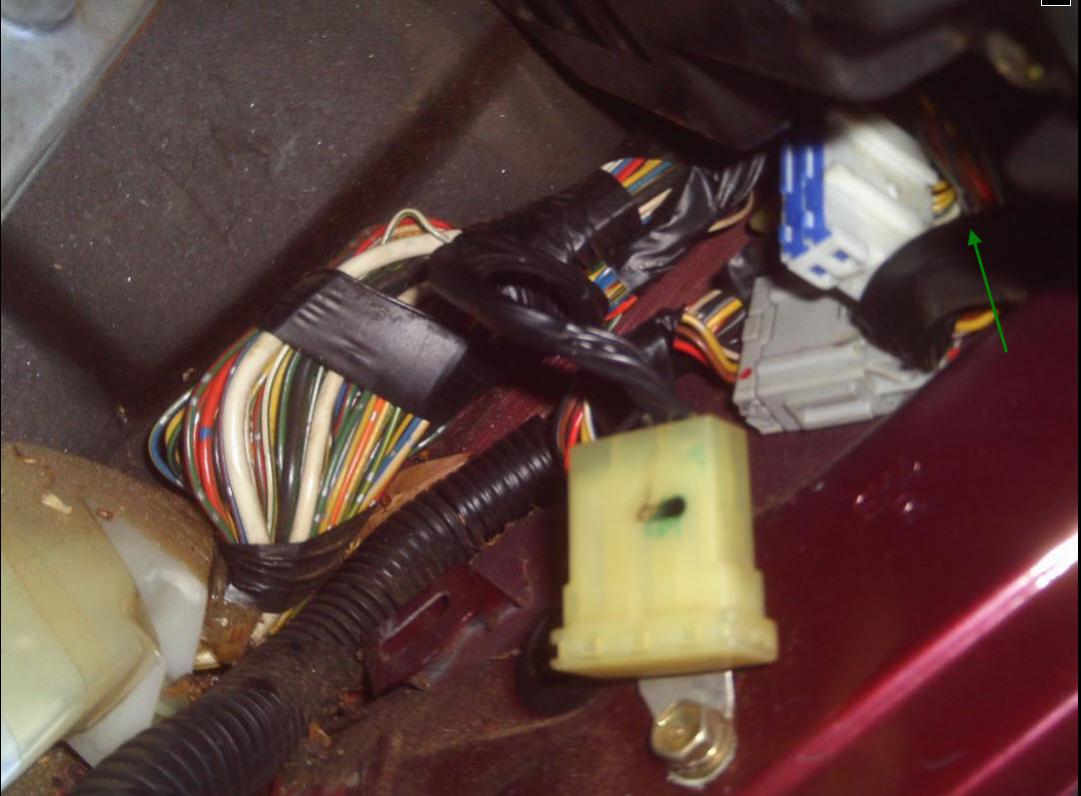

this is all great, but if you look at the pics I posted, I can't find that plug, its not hanging down and I don't see anything that resembles it.

From your picture, there looks to be a green wire that may lead up to the plug. See attached.

Its hard to tell where you are looking at from the pictures. It looks like you removed the plastic kick panel. I would also remove the glove box to get a better look in there. Someone may have tucked the plug away, so now its more difficult to find.

ah well thanks . redbull's repost will give you a starting point. the 2 latter pics I posted are just above and slightly left of the connector with the blue top

From your other post, I thought you finally found it. From this other picture of yours, could this be it (the picture is not in focus)?

yeah I have shaky hands, sorry. you have good eyes, I have been up under there I don't know how many times and never seen it. it's buried up there

Redbull, thatnk you, that was it. so finally I pulled the code and its 41, oxygen sensor heater...so I'm guessing I need a new O2 sensor..
