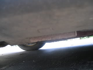

Old Dec 18, 2006 | 04:52 PM
Default RE: Jacking up my honda
here jack it up by these, they are located right behind the front wheels, and right in front of the rear wheels.
