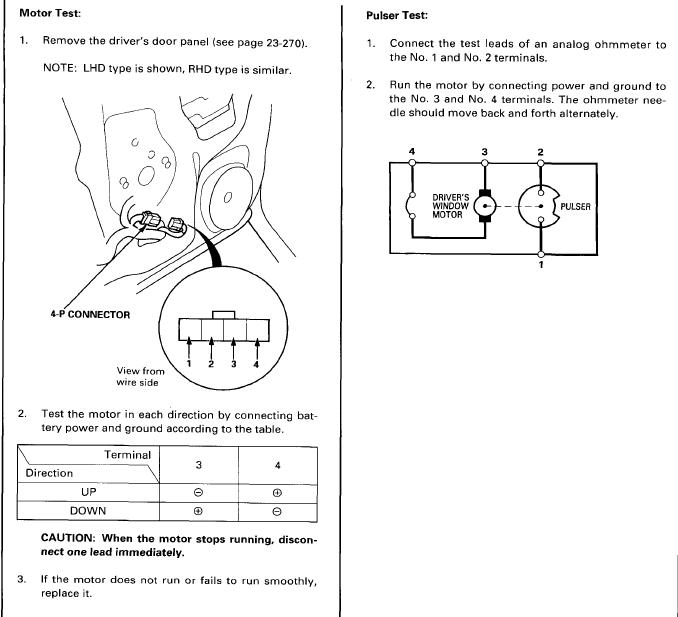

Down:
GRN/WHT TO RED/BLU(1)
RED/YEL(1) TO BLK(2)
Up:
GRN/WHT TO RED/YEL(1)
RED/BLU(1) TO BLK(2)
Try cleaning the contacts on the switch....many times dirt will get in there preventing the contact.

Or to the motor .....use this
Attached Thumbnails Just bought a 1997 Accord-5th-gen-window-test-drivers.jpg
