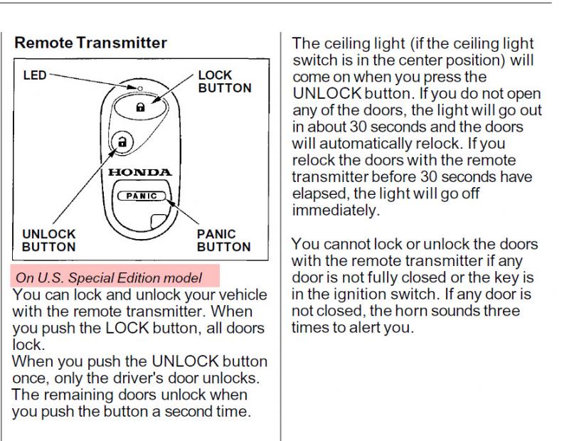

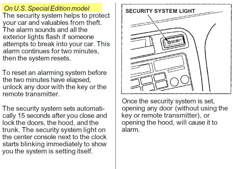

U.S. Special Edition model came with the Keyless/Security Control Unit under the passenger front seat. See various attached pics. for U.S. S.E. model.
I will include some info. that may be applicable for the Canada Special Edition model in a separate post with different pics., so things are less confusing. (You may still have keyless entry with the Canada model.) - Wait for it in the next post...

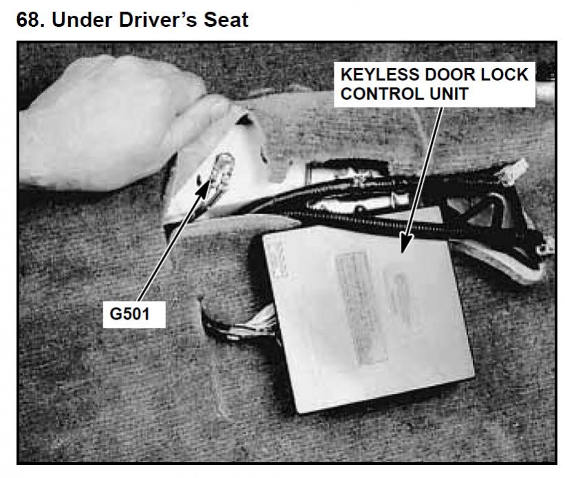

While you may or may not have the security system, you may possibly have the keyless door lock control unit. Look under the driver's seat to see if you have it (see attached pic.). If you do, then getting the remote and programming it probably will work.
These are the programming instructions:
Honda TSB 98-011
Attached Thumbnails Keyless entry or not?-keyless-door-lock-control-unit.jpg   Keyless entry or not?-power-door-lock-control-unit.jpg

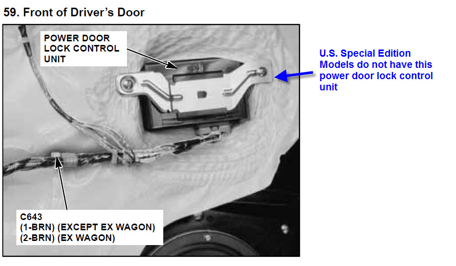

ok well my car has the one from 59 front drivers door
Old Aug 28, 2013 | 11:04 PM
Posts: 7,101
Edit: Check for one under the driver's seat.
The one in the driver's door will not control it remotely unless there is an accessory security system able to drive it. That unit is standard on all models, except U.S. Special Edition model.
