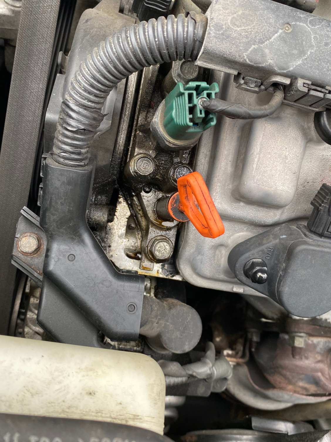

Hey guys,
so I have a leaking spool valve gasket. I yesterday replaced both gaskets on the spool valve, then found it to still leak. I then hondabonded the gaskets, and let it cure overnight. Today I found it to leaking again, just a little less. Previously, it was leaking profusely. I then tightened the bolts, but am afraid to over tighten and break the bolts. Any recommendations? This photo is from me driving at highway speeds for 15 minutes. It is not leaking nearly as much.

I'm not sure I fully understand with the V6, but here goes...
When you change the spool valve gaskets, do you unbolt the part above the dipstick tube or below it? And can you rule out the oil leaking around the dipstick tube?

you unbolt the portion above the dipstick, the three bolts
the leak doesn’t come from the stick, it’s definitely the spool valve

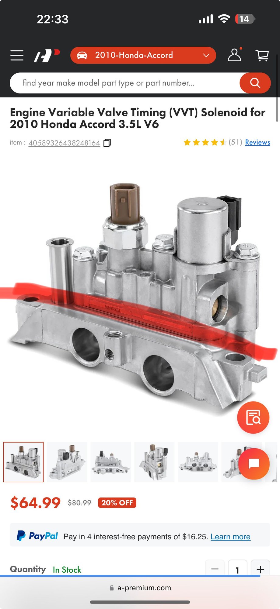

I did end up finally fixing the issue. I purchased an entire spool valve but replaced the top half that you can easily replace from the top of the motor. Look at the red line I drew through the spool valve. Take that top half and replace your old one with that, toss the bottom half because you need to open up the motor to replace the entire thing. Do NOT over torque, ask me how I know. But this is what I did and it fixed the issue for good.
