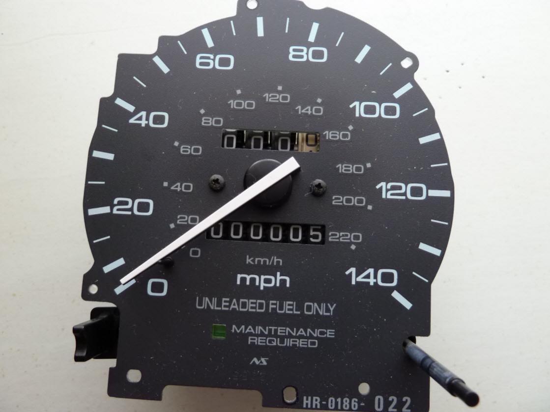

Here is the odometer reset close to zero.
Attached Thumbnails Legality of rolling odometer back or forward (Bad cluster)-speedometer.jpg
