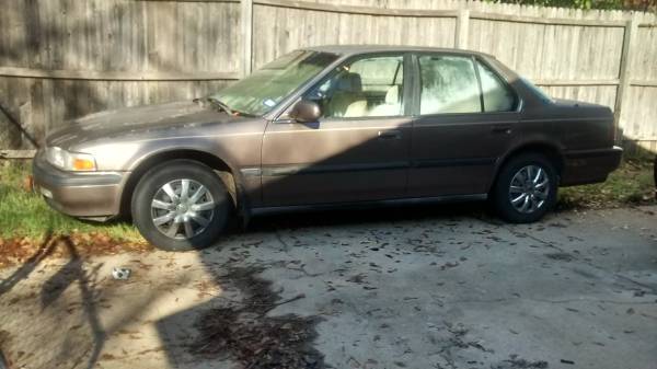

So, it looks like next Friday I will be picking up this older 1991 Accord with the 5-speed in Butt-Nasty Brown for $850:
I've never owned a Honda before, but I've had Nissans forever.
Is this a good group for older Accords?
What should I look out for before taking ownership of the Accord?
What are some typical issues these older style cars are known for?
I'd rather not do any modifications to it. It is just going to be my daily, low dollar, driver to and from work (45-miles away).

4th gen Accords (90-93) are pretty well built. Yours or the one you are looking at is a manual....so that takes any "watch out for auto trans issues"....so regular stuff applies to the hyd clutch system just like many if not all manual trans cars.....trans fluid changes and keep up with the brake fluid in the system for the hyd.
Engine, well it will run a long time if taken care of.....yes the usual stuff - oil changes, tunes ups, ect. The 4 cyl in it is an "interference" engine so the "timing belt job" should be done every 100K~120K miles. I call it a "job" because there are a few things you are looking right at while doing the belt that...well you might as well replace since you are there.....example the water pump is driven by the timing belt so when changing the timing belt why not replace the water pump....do you really want to be back there in 5~10~15K miles because the water pump is leaking. Then there are a few oil seals and o-rings behind there as well.
From there....yea I could "nit pick" about a few little things.....the right rear taillight gasket likes to leak sometimes., valve adjustment should be checked, egr ports in the intake will clog at some point....there are others but nothing really that stands out.
Of course this is an Accord site so, take what I say for what it is. You can search threads on here and other places and that might give you a few more things.
At the end, it is up to you on what you decide.......and the best of luck in whatever that is.
