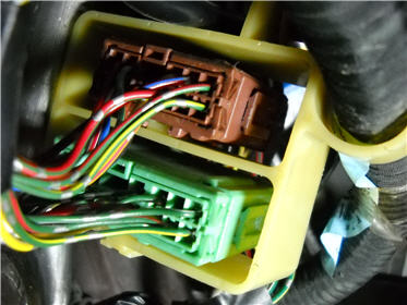

I'm a DIY because I got tired of feeling getting screwed whenever I go to the dealership to get things fixed. My repair skills are quite limited so please forgive me for asking stupid questions. I have 92 accord Wagon with MT myself. I'm pretty sure my main relay is the problem (no click when the check engine light goes away). I have the service manual and electrical troubleshoot manual. The manuals appear to have conflicting info on where this main relay is located. Both manuals seem to call it the PMFI main relay in the schematics. Is this different from the main relay (rusty colored 7 wire gizmo referred to in the thread)? The electrical troubleshoot manual has a picture of the PMFI main relay and it does not look anything at all as the rusty colored relay shown in http://techautorepairs.com/mainrelaydefine.html plus it shows it as being located behind the dash instead of underneath.
Second question: Do you have to remove the dash to get to the main relay you are referring to in this thread or do you just have tough it out, contort yourself, curse and sweat trying to get to it? I'm thinking that since my is MT, Honda placed the main relay behind the dash instead of underneath. I have been trying to remove the dash but I'm having difficulty removing the wire harnesses that I need to unplug (the brown, green, and gray wire harnesses in the attached pictures. With the wire harness being in an awkward location, I cant see the tabs. Thought I ask questions in this forum before I lose patience and do something stupid thats really going to get me screwed.

STOP ,,,,,,,,, right now..........you can remove main relay from under the dash,, NO NEED to remove dash at all.......it takes about 5 minutes to get the relay out,,,,,,,,,
just remove the 2 10mm bolts that hold the cruise control unit,( look at the first link.s picture , it shows you step by step on how to do it.. ) , get a little screwdriver and pry the inner part of the relay out while gently pulling on the plug leaving the outer casing where it is at,, no need to totally remove the relay out of the car ,, once inner part is put, unplug it, from the new relay, take the inner part out, install it in the outer part of old relay casing ,(it will snap in )plug the connector , reconnect cruise box and you are done ..
