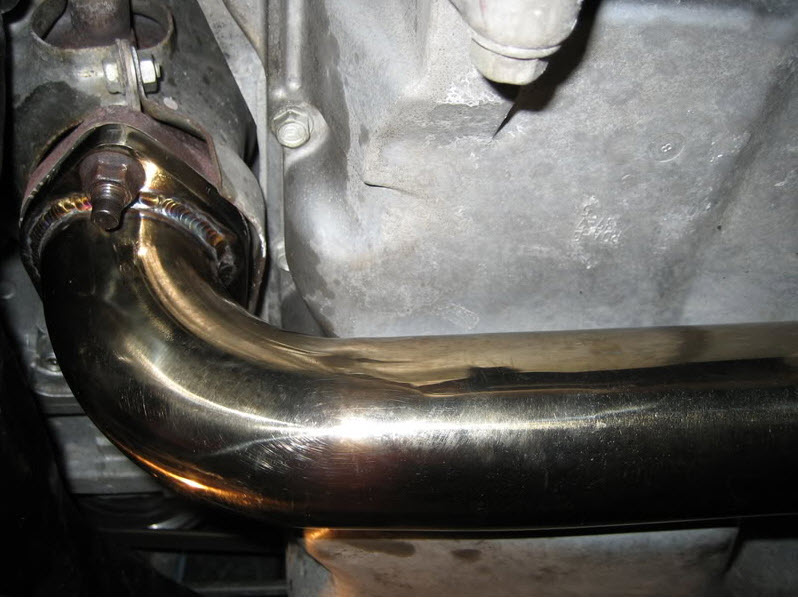

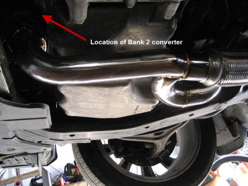

Old Oct 22, 2011 | 08:16 PM
The nuts that attach to the bolts at the bottom of the converter look like easy access, nothing blocking.
The attached pictures were from this thread:
"http://www.v6performance.net/forums/7th-generation-honda-accord-2003-2007/99114-first-production-j-pipe-feeler.html"
From the top, may have to take off one or more plastic covers to give easier access. Possibly might have to remove the coolant reservoir. Air fuel/ratio sensor and oxygen sensor may need to be remove from converter, may or may not be easier to leave the oxygen sensor at the bottom on until the converter is removed. Looks like 4 nuts hold top part of converter to cylinder head.
