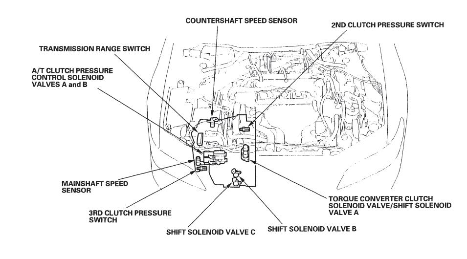

Default Where is the 3rd Clutch Pressure Switch and any procedure ?
folks,
The car has been sititng in my driveway for the past couple of weeks waiting for John (mechanic) to free up.
I figured, I'd try changing the part myself. I cant seem to find the correct location of the 3rd clutch pressure switch and any instructions?
with regards to the idle, i may have posted earlier, it somehow seems to have started after the CEL came on and runs unusally normal when the CEL is turned OFF for the first day or 2...It is difficult to believe but somehow the P1457 and idle issues are connected to each other. (ericthecarguy on youtube seems to think so too as well)
thank you
Old Oct 23, 2013 | 06:01 PM
  #30
This is for a four cyl.....can't remember if you have a 4 or 6?
Attached Thumbnails My recent issue(question) and atf-z1 (never changed it) on my 2000 honda accord?-6th-gen-trans-solenoids-4-cyl.jpg
